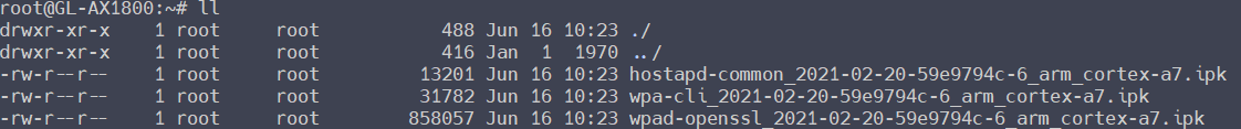

Please update these files:
4.6.11_hostapd_debug.zip (882.8 KB)
  1. Unzip and upload 3 .ipk files to /root/ by WinSCP
  2. SSH to the router, and execute the commands to install:
opkg install wpa-cli_2021-02-20-59e9794c-6_arm_cortex-a7.ipk && opkg remove wpad-openssl && opkg install wpad-openssl_2021-02-20-59e9794c-6_arm_cortex-a7.ipk && opkg install hostapd-common_2021-02-20-59e9794c-6_arm_cortex-a7.ipk --force-reinstall && /etc/init.d/repeater restart
  1. Follow you mentioned method, add parameters -d -t, and restart wpad: /etc/init.d/wpad restart
  2. Check the debug log: logread -f&
