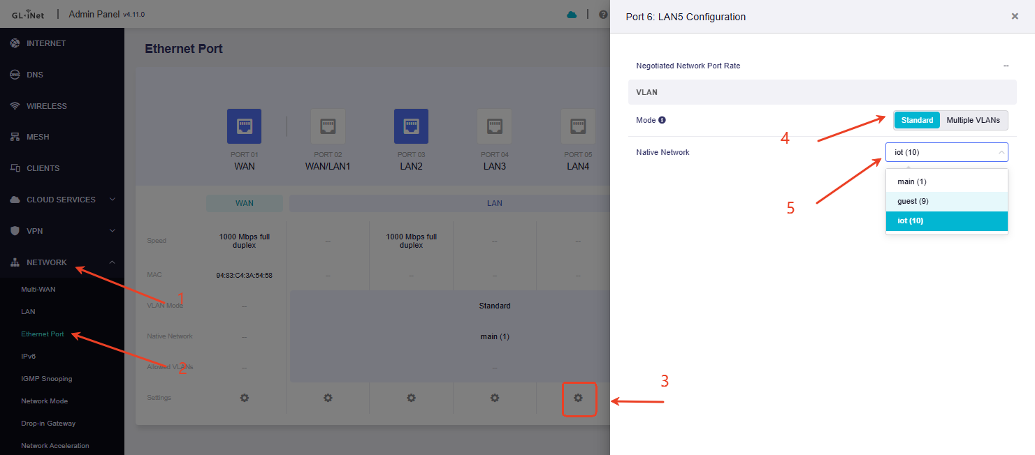

Flint 2 now has an SDK v4.11 Beta firmware available. If you are willing to try the beta firmware, this configuration can be done directly from the GL.iNet Admin Panel.
After upgrading, go to NETWORK → Ethernet Port , select the LAN port you would like to use for the Sengled Hub, keep it in Standard Mode , and set Access Network to the IoT Network .
Then the device connected to this port will then become part of the IoT network.

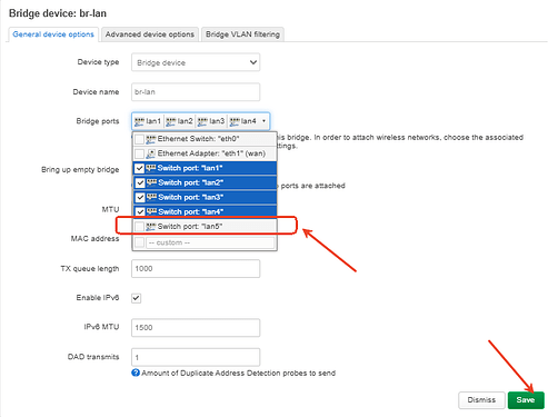

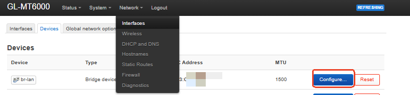

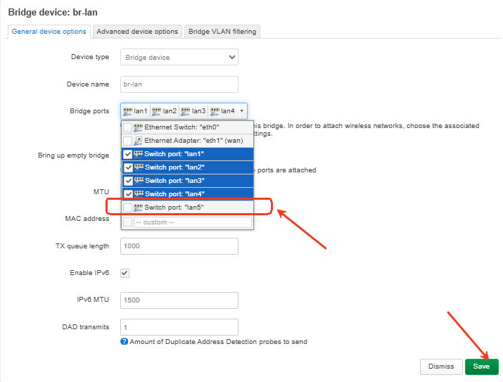

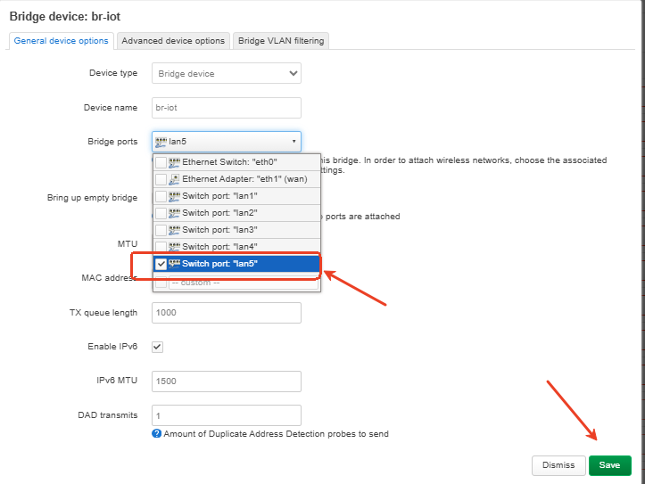

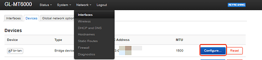

If you prefer to stay on your current firmware, you can also configure this through LuCI:
  1. Go to SYSTEM → Advanced Settings → Go to LuCI .
  2. Go to Network → Interfaces → Devices .
  3. Edit br-lan and remove the LAN port you would like to use for IoT.
  4. Edit br-iot and add the same LAN port to its Bridge ports .
  5. Click Save & Apply .
