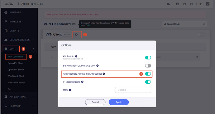

  1. Go to Admin Panel → VPN → VPN Dashboard and verify that Allow Remote Access to the LAN Subnet is enabled.
  2. If it is already enabled but the issue still persists, could you please follow the guide below and share your device with us via GoodCloud so we can investigate it remotely?
