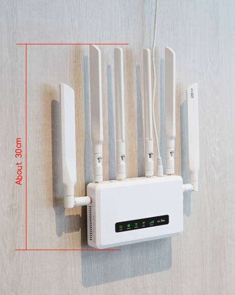

    The router is (or will be installled) in a cupboard. How tall is the X3000 Spitz including the Wifi / LTE antennas?

  3. The antenna you should ask is supposed to be like it stands with the device, the longest about 30cm (Manual measurement, for reference only)

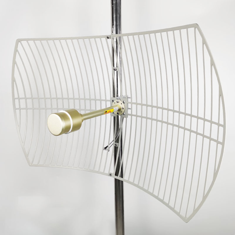

Sorry I'm not Bruce Almighty))).This is my favorite American movie.If I were Bruce Almighty I would make all routers temperature 30°Now all the equipment is hot.In my ZTE router I also have 70°.Thermal pads are used everywhere now.If you put the router under a fan, the temperature does not drop below 50° because of the thermal pads.In any case, it's not very good when the router is hot.But now all the routers are hotter.The world is moving towards increasing frequency, which leads to an inevitable increase in temperature.When the processor is soldered, the air flow temperature is 400°.And for some reason he doesn't die...
A few words about antennas.You are unlikely to find omnidirectional antennas that perform better than router antennas.If you move the original antennas to the roof, the increase will be noticeable.If it works poorly, you need to buy a parabolic antenna.All other antennas will perform worse.Up to 5 m use the blue rg402 cable, it is thin and high frequency, it is on Aliexpress.The main thing is that no miracle antennas from Aliexpress, all sorts of small boxes will most likely work worse than router antennas.The principle of operation of a parabolic antenna is the same as the principle of operation of a car reflector headlight.Remember How a light bulb shines without a reflector without a headlight and How a light bulb shines in a headlight...It's the same here, only radio waves instead of light.
