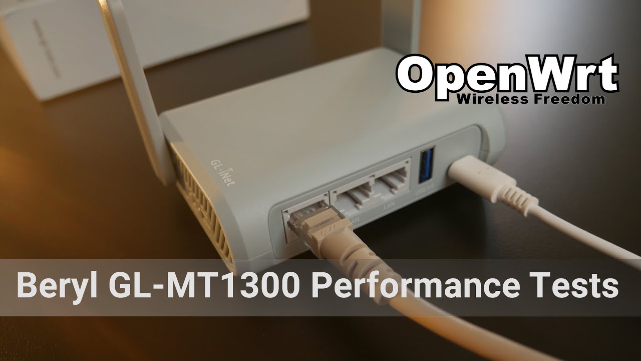

I believe what I’m seeing is a lack of hardware flow offloading. The issue referenced in the video below is almost exactly what I’m seeing. I can’t run htop but I’m seeing almost exactly 25% cpu usage when running a speedtest. That suspiciously looks like I’m running 1 core at 100%. (4 core cpu onboard)
In the video, he enables the hardware flow offloading in the command line. I went through the Luci console and checked and confirmed it is enabled both in the interface and from the command line.
root@GL-MT1300:~# uci show | grep 'offloading'
firewall.@defaults[0].flow_offloading='1'
firewall.@defaults[0].flow_offloading_hw='1'
So maybe a firmware bug?

Why can’t you run htop? opkg update && opkg install htop .
I’ll go watch that vidja now, standby…
Ah, thanks for the package… it just wasn’t loaded.
After running htop, I can see a single core go to 100% during a speed test. I even back-rev’d the firmware to that last 3.x build and I see the same thing.
The striking thing about Van Tech’s test is @ 9.46: he’s not connected via WG or OVPN when running a H/W offloaded test. What kind of VPN rates to do you get when offload is disabled?
I think it’s also worth mentioning that Nord puts their own ‘flavour’ on WireGuard… & call it NordLynx. It’s enough of a reason I stay away fr 'em. You might want to consider a 30 day period of a ‘pure WG’ provider just to remove that variable but as always, YMMV:
