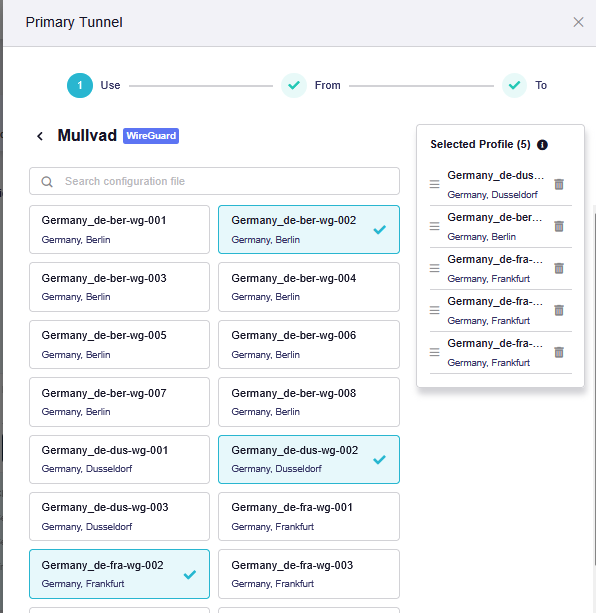

I have set up multiple wireguard connection profiles as failover which is supported in fw 4.9.0, but it never works. I just had another wg server problem but the failover didnt work and I had to manually switch servers.

In firmware v4.9.0, when multiple profiles are selected within the same VPN tunnel, the router monitors the currently active profile. When the current profile is detected as failed, the tunnel should automatically try the next profile in the list.

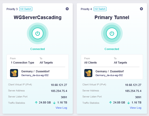

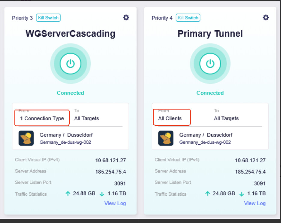

From the screenshot, both WGServerCascading and Primary Tunnel are currently using the same Mullvad profile and server.
The difference is their traffic source: WGServerCascading appears to apply to clients connected through the VPN Server, while Primary Tunnel applies to All Clients.

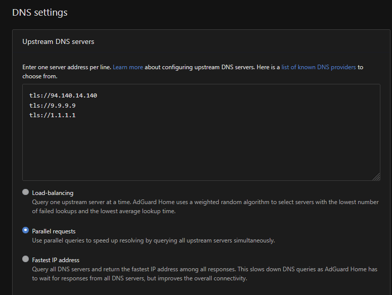

When the issue happened I already did the test upstreams in Adguard and this came out

I have a suspicion that Adguard randomly stops working even I have multiple DNS set up and parallel requests active, it somehow totally breaks down for these short period of times. Either this is a bug in Adguard, or the VPN for real stopped working, but then the failover didnt work. What is the testing time window for the current implementation of the fail over? Maybe it is too short?

Could it also be that 1.1.1.1 randomly blocks Mullvad traffic? I have a lot of Cloudfare blocks on my clients with lots of Mullvad servers. But the DNS shouldnt block as I read into it no matter what. Also I have 3 DNS set up in Adguard:
tls://94.140.14.140
tls://9.9.9.9
tls://1.1.1.1
with parallel request active. I set it to parallel because I wanted to see if that helps anything, but it didnt.

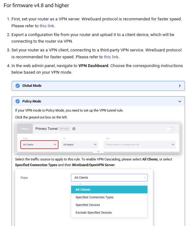

I did this because of the change of the Dashboard with the fw change. Did I do it right? I just wanted to set up wireguard server cascading, but it is a bit counterintuitive set it up like this with the new way the new Dashboard works.

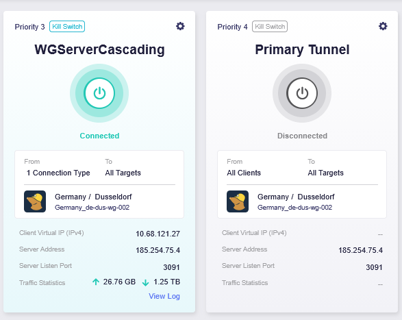

If stop the main tunnel, it still shows WGServerCascading “connected”. This makes zero sense! I dont want 2 connections, and also how does it first show the same one, but if you disconnect primary, it still shows primary on with WGServerCascading ?
The web documentation is also not properly changed for this and doesnt help at all how to properly set it up:
Even under fw 4.8 and higher it doesnt show the new web interface and how to set up wg server cascading properly next to main vpn

Regarding AdGuard Home, the screenshot confirms that AdGuard Home could not use tls://9.9.9.9:853 at that moment.
However, Parallel requests sends each DNS query to all configured upstream servers and uses the first valid response, so one unavailable upstream alone should not normally cause DNS to stop completely.
To rule out an upstream configuration issue, could you please change the mode to Load-balancing and test one official DoT hostname at a time:
tls://unfiltered.adguard-dns.com
tls://dns.quad9.net
tls://one.one.one.one
If the issue occurs again, please also check whether the affected client can ping 1.1.1.1 .
If the IP is reachable but domains cannot be resolved, the issue is related to DNS; if the IP is also unreachable, we will need to investigate the VPN data path.
Regarding VPN Cascading, in firmware 4.9, All Clients already includes clients connected to the router’s WireGuard or OpenVPN Server.
If both local clients and VPN Server clients use the same Mullvad connection, you need one Primary Tunnel configured as From: All Clients and To: All Targets .
The separate WGServerCascading tunnel is an independent VPN instance, which is why it remains connected after Primary Tunnel is disconnected.
A separate cascading tunnel is required if VPN Server clients need to use a different VPN Profile or policy from local clients.
