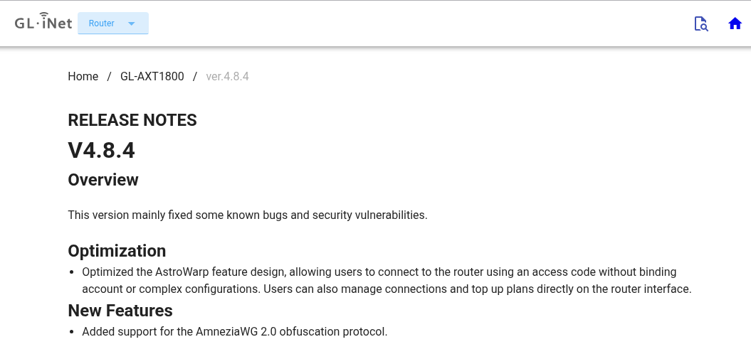

FYI to all.. GL reverted out the AWG2.0 features of the SlateAX 4.8.3-beta firmware when pushing to 4.8.3 stable. (Transparency would be nice btw).
4.8.4-beta should now include AWG2 (going to review tomorrow to see if it has the same broken implementation as 4.8.3-beta did).
I am using 4.8.4 on my slate GLAXT1800 and running the new amezia protocol back to my Flint 3 with 4.9 beta 4 at home without issue so far.
@ChrisC then the client profiles and params must have been generated on the other device. The ones that the SlateAX 4.8.4 autogenerate remain broken. For example, you cannot put spaces in between the H param ranges:
For all.. Slate AX 4.8.4, there’s still several AWG2 issues:
  1. kmod is still built on v1.0.20260210, which has several bad (hard freeze) bugs that have been fixed in upstream this past month
  2. no support for “I” parameters
  3. incorrect formatting for H paramters.
This is still very much alpha/beta support.
