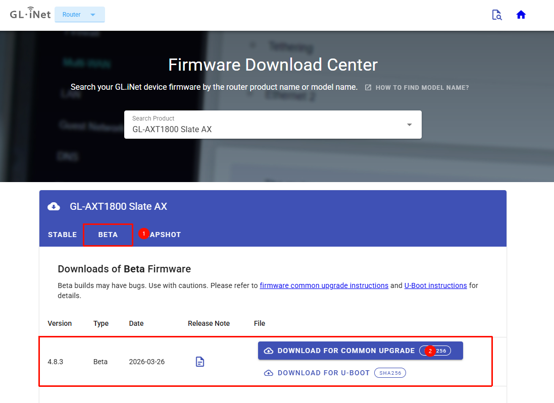

We released the 4.8.3 beta firmware for the AXT1800 today, which adds support for AmneziaWG.
If you’re interested, feel free to download it and give it a try.
DL Link: GL.iNet download center
Upgrade Guide: Upgrade - GL.iNet Router Docs 4

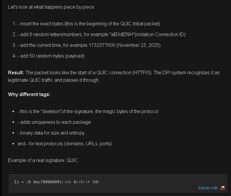

CPS - traffic masking language
What is CPS in simple words
CPS (Custom Protocol Signature) is a special format for describing what signature packets (I1-I5) should look like. You could say it's a "constructor"for creating fake packages.
Analogy from life:
Imagine a theatrical performance. Your VPN traffic is an actor that must get past the guard (DPI system). CPS is the script and the costume. You write: "put on a police uniform, show your badge with the number, say 'patrol number 47'". The security guard sees the policeman and lets him through without checking what is under the uniform.

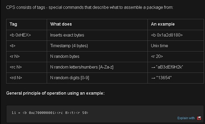

Available CPS Tags
CPS consists of tags - special commands that describe what to assemble a package from:
How does this work:
The DPI system looks at the beginning of the packet (the first 50-200 bytes) and looks for familiar protocol patterns. If it sees, for example, the beginning of a DNS request, it passes it through as legitimate traffic. The real WireGuard handshake comes next, after our "mask".
What's going on here:
  • beginning of the QUIC package:
  • 0xc7 - packet type (QUIC Initial)
  • 0x00000001 - version QUIC v1
  • 0x0 - the beginning of the Connection ID
  • 8 random characters for Connection ID
    Each connection will look different: "aB3dEf9H", "xY7zK2mN", "pQ9rS4tU"
  • timestamp (different for each handshake)
  • 50 random bytes payload
Why it works:
  • DPI sees the first bytes 0xc7 0x00000001 - characteristic of QUIC
  • Connection ID looks real thanks to
  • The packet size is adequate (~70-80 bytes)
  • Wireshark defines this as the "QUIC"protocol
  • DPI passes both HTTP/3 traffic

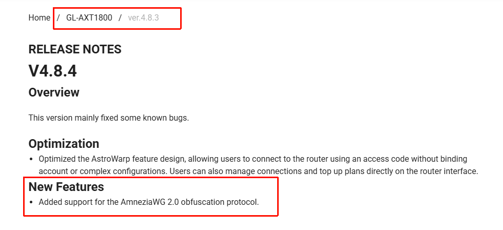

Hi, I can’t see any download links. It looks like this version has not been published yet.
Please check your network and try using a different browser or incognito mode. It’s working normally on our end.
Hi, I mean that you mentioned firmware version 4.8.4 earlier, but only 4.8.3 is currently available on the server.
Oh, I made a typo. The v4.8.3 beta is the correct version.
Thanks for pointing that out. I’ve corrected it.
