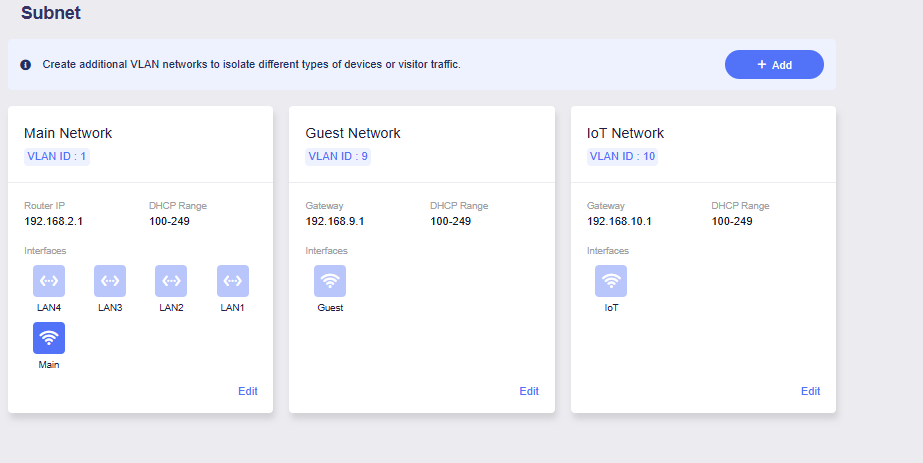

Thanks for the pointer — that Subnet page is exactly the direction I was hoping for. Custom VLAN networks with their own gateway, DHCP, AP isolation and WAN access control per subnet would solve the three-slot ceiling entirely.
One thing I noticed: the page documents creating the subnets but doesn't mention the VPN side at all. My use case depends on being able to select a new subnet as a source in VPN Policy Mode, the way Guest Network can be selected today. If that plumbing isn't there, extra subnets don't help me. Does anyone know whether VLAN networks created on the Subnet page appear as selectable sources in Policy Mode?
On your Blink issue — I think the same feature helps you, for a slightly different reason. Your problem is that AP Isolation has to be OFF so the camera can reach its sync module, but you presumably still want the cameras separated from your main network. Those are two different isolation mechanisms that currently get conflated: AP Isolation controls whether devices on the same network can see each other, while subnet separation controls whether they can see the other networks. Right now you're forced to choose.
With custom subnets you could put a dedicated camera subnet in place, leave AP Isolation off inside it so the camera and sync module talk normally, and rely on it being its own subnet to keep it away from your main LAN. Best of both, rather than trading one against the other.

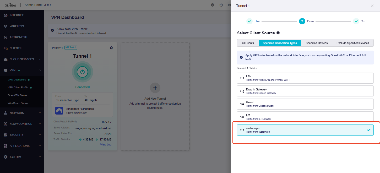

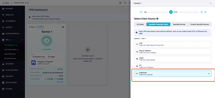

A custom network can be used as a separate source in VPN Policy Mode and assigned to a different VPN tunnel.
For the current v4.9.x firmware on Slate 7 (GL-BE3600), you can also create an additional Wi-Fi network manually.
The following example creates a new independent network named customvpn , with both a 2.4 GHz and 5 GHz SSID, and makes this network available as a source in VPN Policy Mode.
Before applying the configuration, please first make sure wifi2g2 , wifi5g2 , wlan05 , and wlan15 are not already being used:
uci show wireless | grep -E "wifi2g2|wifi5g2|wlan05|wlan15"
If there is no output, you can use the following configuration. Please replace YOUR_WIFI_PASSWORD with your preferred Wi-Fi password.

# Add the custom network as a VPN Policy source
uci add_list route_policy.global.append_source_if='customvpn'
# Save the configuration
uci commit network
uci commit dhcp
uci commit firewall
uci commit wireless
uci commit route_policy
reboot
This configuration creates an independent 192.168.20.0/24 network, with the router using 192.168.20.1 as its gateway and DHCP server. Both Custom-VPN-2.4G and Custom-VPN-5G are attached to the same customvpn network, so devices connected to either SSID will receive a 192.168.20.x address.
After the router reboots, go to: VPN Dashboard → Add/Edit Tunnel → From → Specified Connection Types

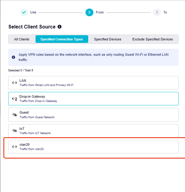

One follow-up: when the Subnet page arrives on the Slate 7 in v4.10, will networks created there appear as Policy Mode sources automatically, without the CLI step?
Thanks for the follow-up.
Based on the current implementation of the Subnet feature, a custom network created from the Subnet page will automatically appear under VPN Dashboard → Policy Mode → Specified Connection Types .
One thing to note is that if you want to create an additional custom Wi-Fi SSID for that subnet, some extra configuration may still be required to create the Wi-Fi interface and bind it to the newly created subnet.

At this stage, creating and binding an additional custom Wi-Fi SSID is not available in the GL.iNet Admin Panel. You will need to use LuCI to create the new Wi-Fi SSID and bind it to the newly created subnet.
When it is bound, devices connected to that SSID will join the corresponding subnet and use its network settings and policies.
You can think of a subnet as a separate network created within your router. It can have its own IP address range, DHCP settings, and access rules, allowing you to separate certain devices from your main network.
In v4.10, the Subnet feature is intended to make it easier to create and manage additional networks beyond the default Main, Guest, and IoT networks.
You can refer to our documentation to learn more about how this feature works:

Are the Guest and IoT networks considered subnets?
At present, the GL.iNet Admin Panel does not provide an option to create and bind additional custom Wi-Fi SSIDs.
Since VAP support and implementation can vary between different device models and wireless platforms, this type of configuration is currently handled through the underlying OpenWrt interface instead.
For now, additional custom Wi-Fi SSIDs can be created and configured through LuCI or the command line.
Regarding the Guest and IoT networks, they are separate networks/subnets from the main LAN and have their own network and firewall configuration.
