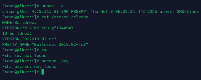

It is for Pikvm but I use glkvm Comet (GL-RM1).And unfortunately those commands does not work. It is based on Linux glkvm 4.19.111 armv7l.
Thank you but commands does not work could you help me it says pacman not found:

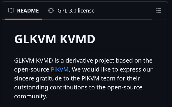

OMFG! GL.iNet isn't building on Arch Linux. They took PiKVM's python scripts but without deploying on the same underlying OS! I guess no one in GL.iNet bothered to look up Arch Linux ARM! Well done, GL.iNet. Exceptional work.
It's just like your routers, all over again.

@9b9e69c2-4b75-4420 Not sure why the need to hate on them for not using Arch. The GL.iNet Comet KVM doesn't use Arch Linux and there's no actual need to do so.
As is, the system is capable of running wireguard manually.
