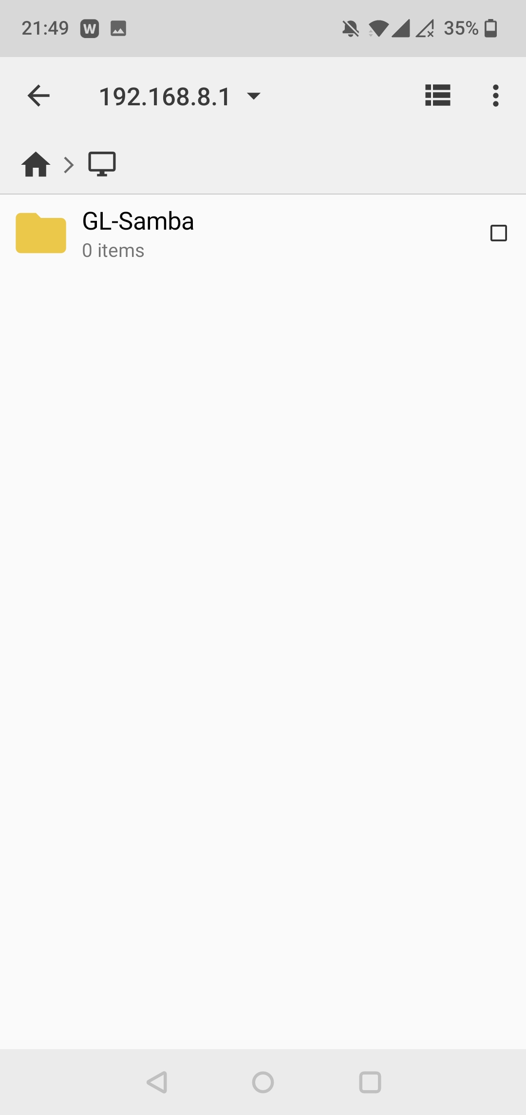

Using a mango, have followed the instructions to enable file sharing. The folder for the router appears, but shows empty (there are files on the attached usb drive). Is there an easy fix to be able to see the files?
The sharing path is correct right? Can you give some details e.g. screenshot.
Will post screenshots later as away from the router, I have followed the instructions as posted on the GL.inet tutorials, I can see the main folder, just contains nothing.

I’m accessing via Android, screenshots are vlc and cx file Explorer, can see folder but it is empty, any help appreciated

in router system, you installed the “file share” , so it can appear “GL-Samba”。 if you USB device not recognized by router, it can’t be find in “GL-Samba” directory。
you can ssh login the router system, check the USB device whether be found.
