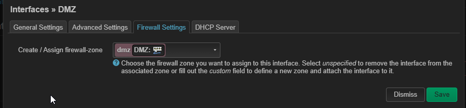

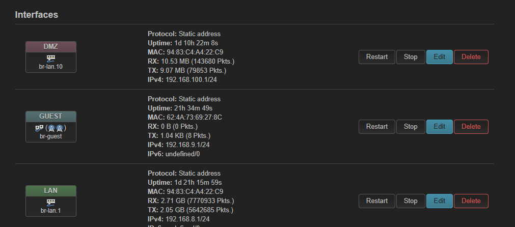

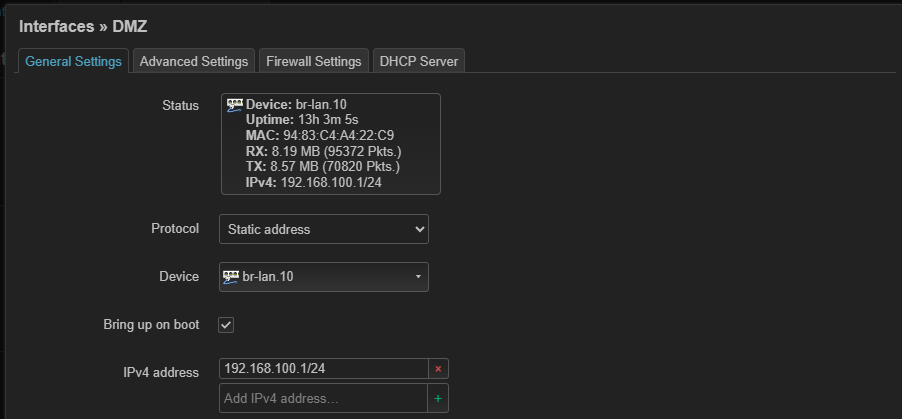

I've created interface on br-lan.10
And assigned it to DMZ zone

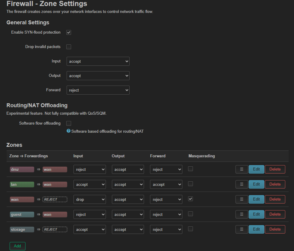

Here's my fw setup:

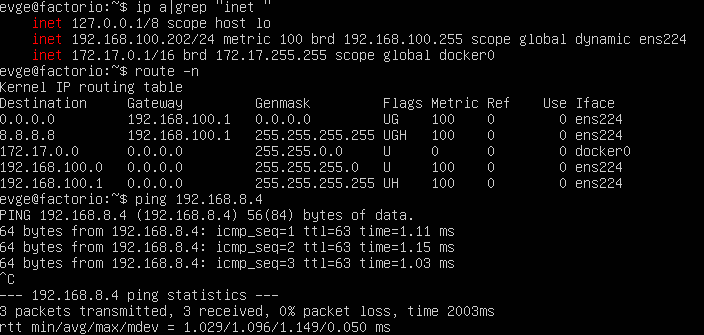

In my understanding a client from dmz shouldn't have access to lan, however:
Why the host from DMZ vlan is still able to reach a host from lan?
Because your default setting is to allow?

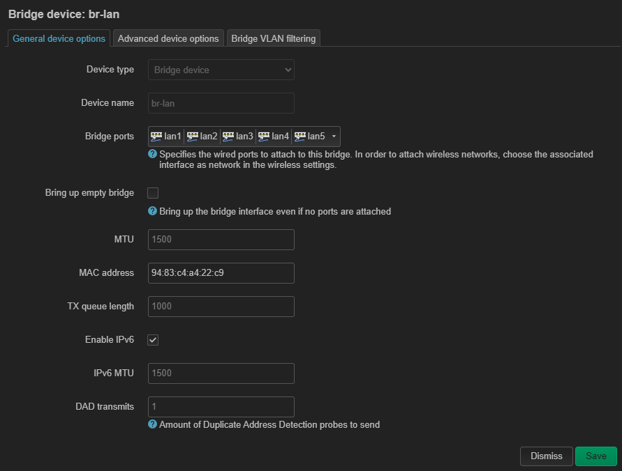

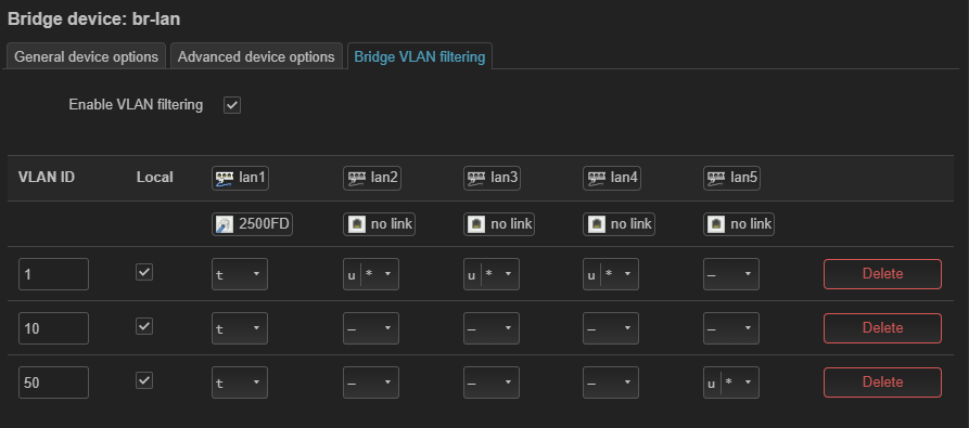

You set up a bridge, so it would be helpful to see what is included in your bridge. Also, if you kept that interface in your lan bridge, and your vlans are only tagged with no default, i am not sure the firewall would even be in play. Perhaps someone way smarter than I am can look into this further with you, but when I set up my vlans, I just assigned the interface and did not configure a new bridge and all of my vlans are untagged allowing my swtich to control vlan membership.

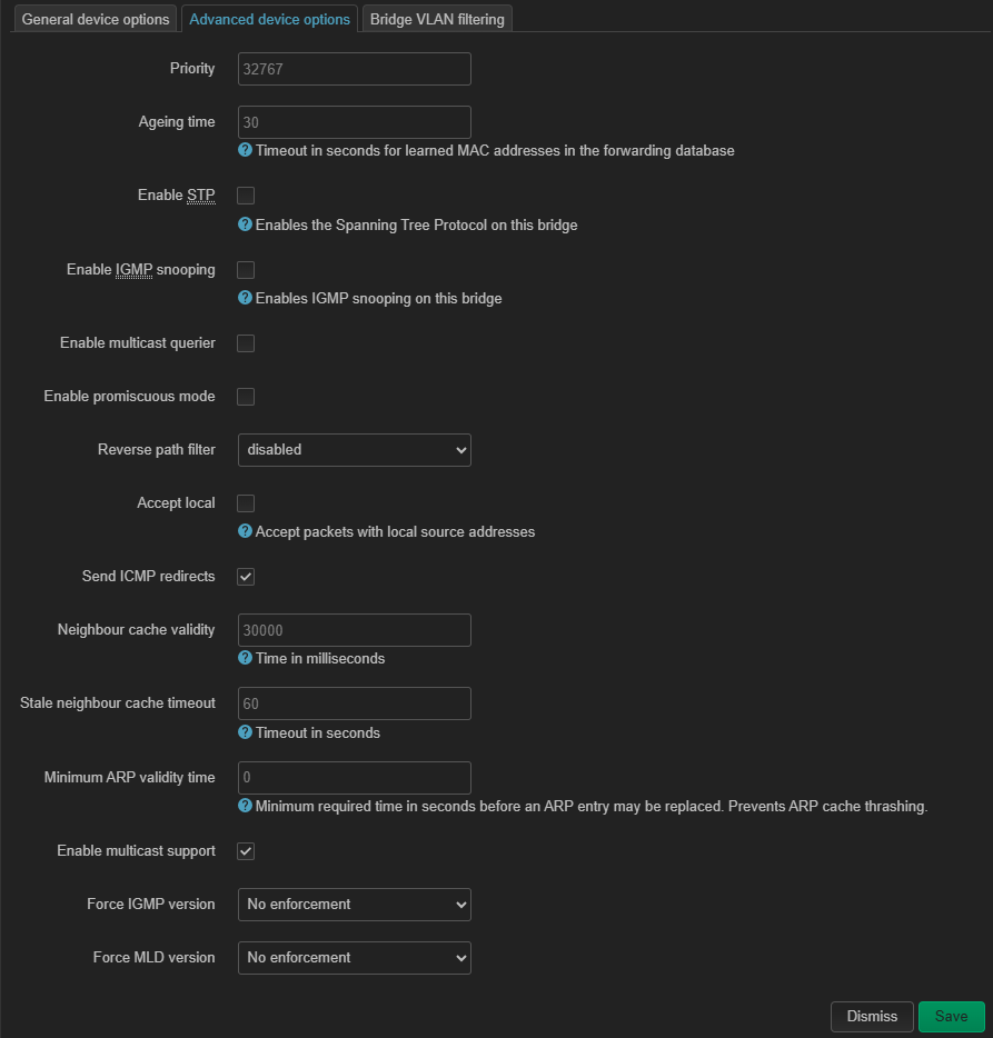

There's a screenshot with my bridge setup:
Other settings below:
I have a separate interface for each VLAN on the same bridge
Should I move my vlans to different bridges to make the firewall work?
Still looking for some help on this

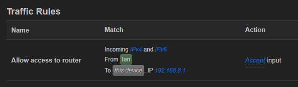

It truns out the default input action should be deny indeed, and in order to prevent complete router unavailability I had to create allow rule to "this device" first
