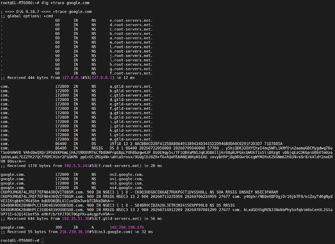

  3. You can SSH into the router and run the following command to simulate how a recursive DNS server works, and check whether your ISP is hijacking DNS traffic and causing the failure:
    dig +trace google.com
    Expected result:
