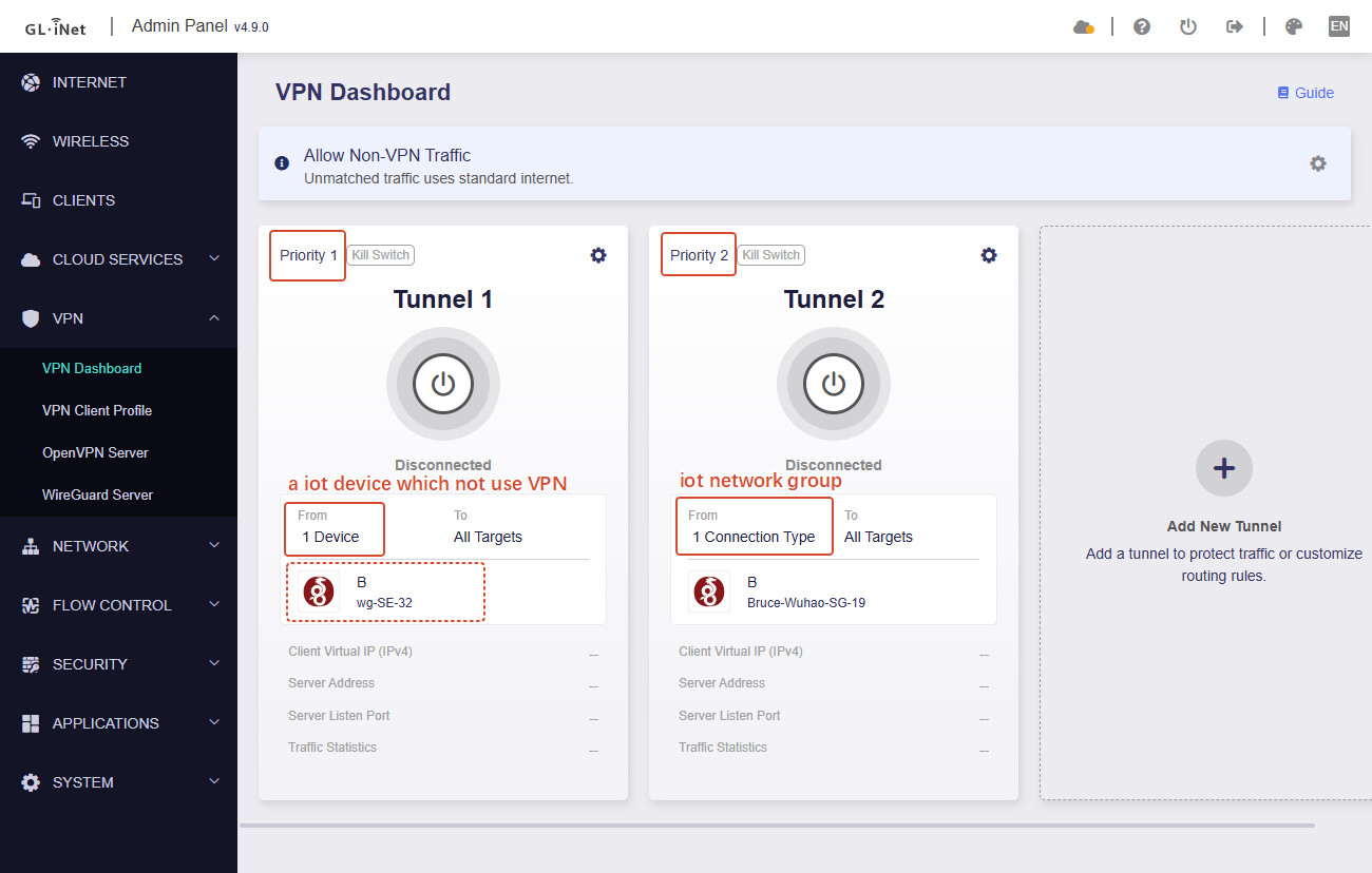

  1. Create a new VPN tunnel in GL GUI, choose any one VPN profile, set "one specific IoT device to be excluded from using the VPN", and priority to 1
  2. Create a second VPN tunnel in GL GUI, choose the desired VPN profile, check the IoT network interface, and priority to 2.
    After completing steps 1–2, it should look roughly like this:

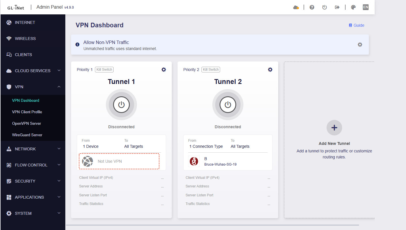

  3. SSH to the router, execute following command to set the VPN tunnel with priority 1 to "not use VPN":
    uci set route_policy.@rule[0].via_type=novpn
    #rule[0] is the tunnel with priority 1, #rule[1] is the tunnel with priority 2, and so on.
    uci commit route_policy
    /etc/init.d/vpn-client restart
    After completing steps 3, it should look roughly like this:
    If you see the Priority 1 tunnel change to "not use VPN", means the command execute was successful.
    This achieves excluding one specific IoT device from using the VPN while the other IoT devices (the IoT network group) use the VPN.
