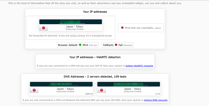

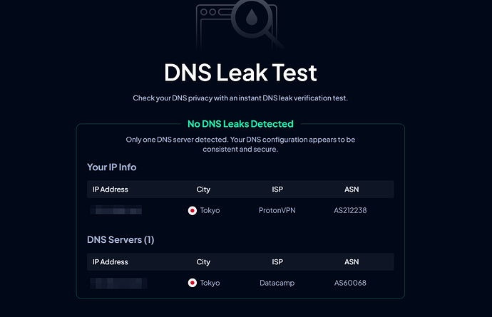

I’d like to know what causes and in what scenarios, to bring the VPN tunnel and ADG be disabled at the scheduled time.

Sorry for the late reply.
We conducted local testing but were unable to reproduce the issue.

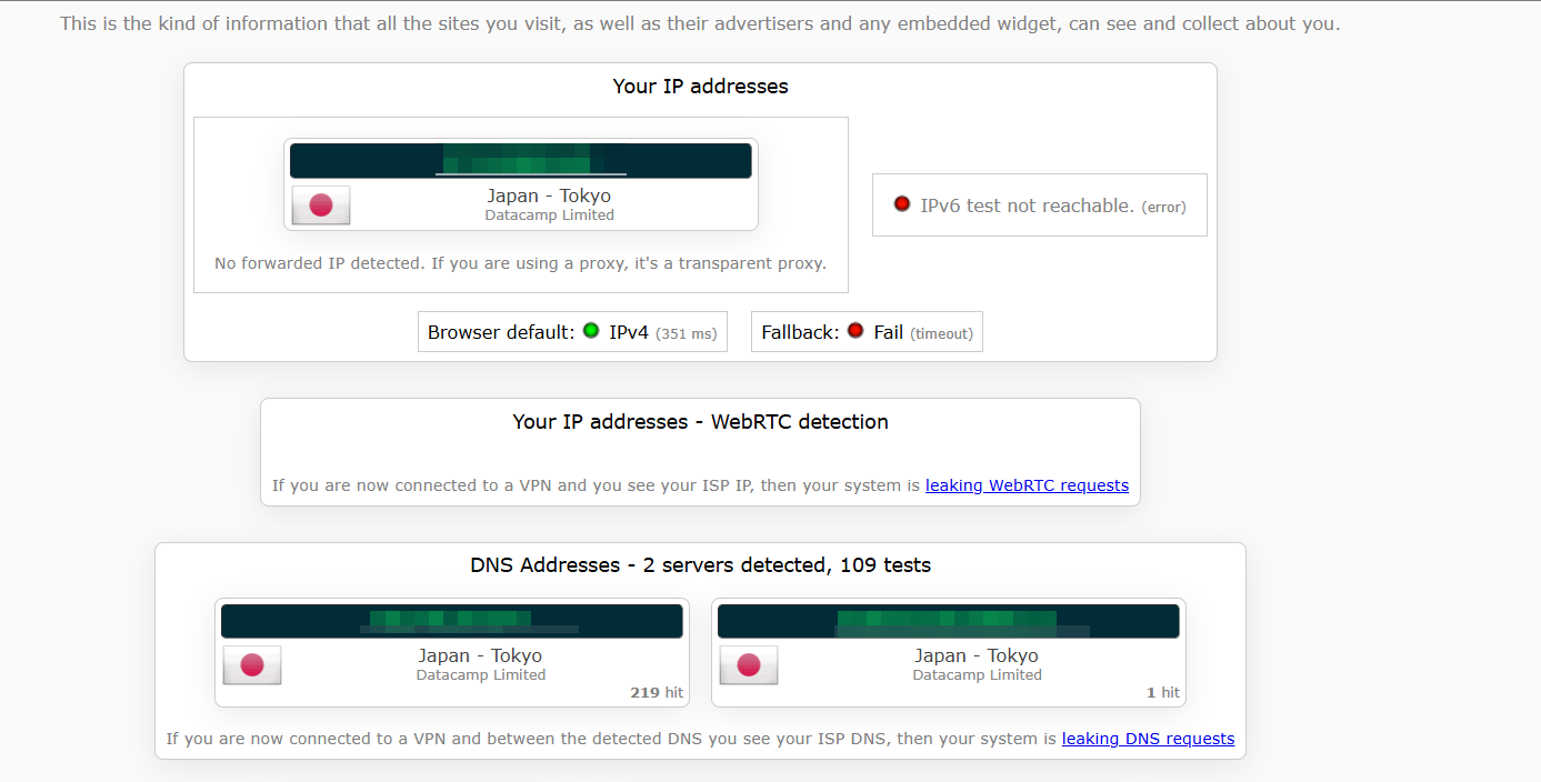

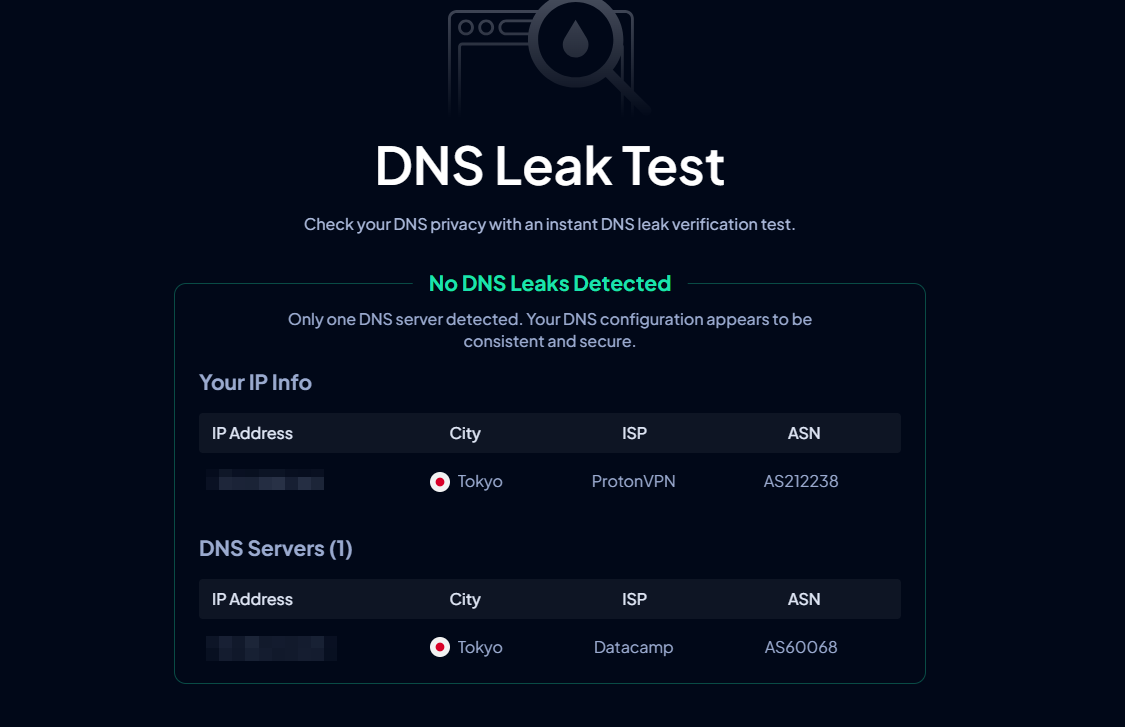

Since we’ve released a new beta firmware (Flint3 v4.9.0 beta4) that fixes the issue with using VPN and AdGuard Home together.
Could you update to this version and check again whether there is any DNS leak?
Please note that some VPN providers may redirect DNS for various reasons. We recommend configuring encrypted DNS as the upstream in AdGuard Home for testing.
If the issue persists, please share (via private message) your
  • VPN provider
  • AdGuard Home upstream DNS settings
  • and the results from those test sites
    so we can review further.
Hi, yes I've already upgraded to Beta 4 and I can confirm that the issue has been resolved, thanks.
