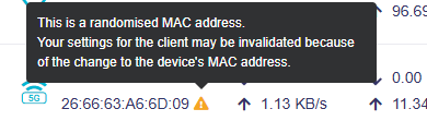

We already included this clarification in the interface notice, as shown here.
It informs users that MAC-based controls can be bypassed and are not fully reliable.
