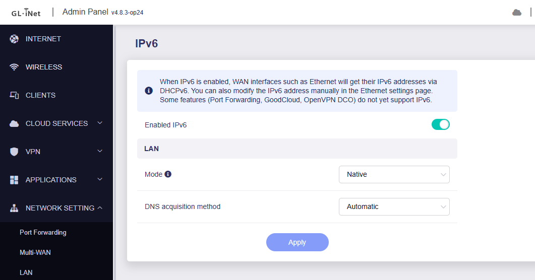

Updated to op24 4.8.3 Fw and still im not able to get ipv6 working. No client via Lan is getting. Wlan clients get ipv6 ip, no issue. Since hakf a year this is broken. Issues with dns and ipv6. Dont know what changed there but really frustrating. Zried with chatgpt to find issues but nothing worked. Im on native ipv6 and there is no problem getting ipv6 connection via pppoe. The router isnt going to give ips to the clients. I dont know what to do more if its firmware issue. Worked with 4.7.7 op21 build like a charm.

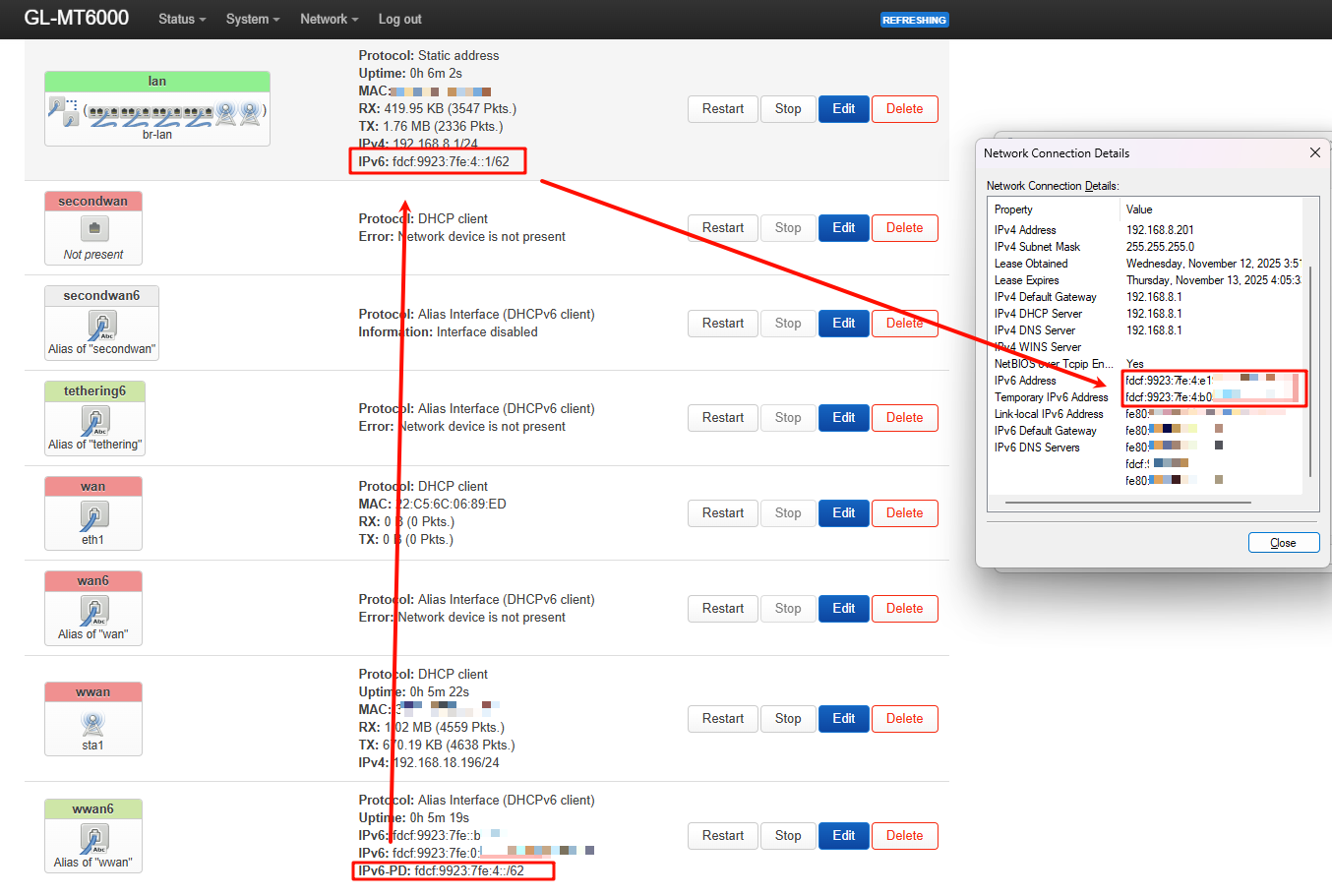

We tested using Flint 2 with firmware version 4.8.3-op24 but were unable to reproduce the issue.
The LAN device successfully obtained an IPv6 address from the WAN IPv6-PD.
IPv6 Settings:
Router & LAN IPv6 address:
Could you please confirm that IPv6 DHCP is enabled on your LAN device for address assignment?
If possible, please share your Flint 2 with us via GoodCloud by following this guide:
Afterward, please send us the device’s MAC address and WebUI login password via private message so we can perform a remote check.

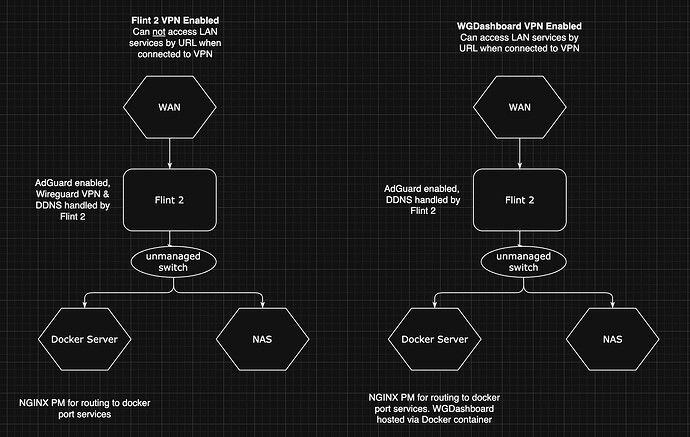

@will.qiu my issue is that I am hosting internal web services on my LAN. When connect via WG I cn only access those services by IP, not the WAN URL which DDNS back to my LAN. AGH is enabled.

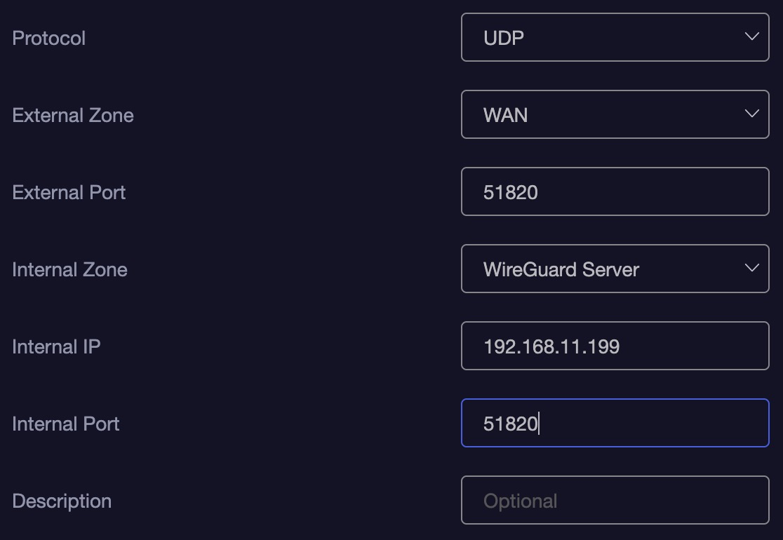

Hosting my own WG server via Docker allows me to access them via IP and WAN URL. But NOT the Flint 2 WG server. Did something change? Do I need to add a static route somewhere.Do I need to add a port forward to the Wireguard LAN in the Flint?
  1. I tried disabling AGH but it didn’t work.
  2. DNS is 1.1.1.1 on my Docker WG server that works.
  3. Domain names are being mapped/routed through Nginx PM also running in Docker.
  4. I own a FQDN that is DDNS through another 3rd party company

If possible, please provide a detailed network topology. This will help us better understand the issue and set up a local test environment for verification.

In the past I had a similar issue that was resolved by adding a port forward rule to the Flint’s wireguard internal zone. This ensured when on the VPN I had access to LAN and LAN/WAN services. But I don’t believe this is good practice, but it worked until the FW upgrade.
Here’s an example.
Here’s a topology example

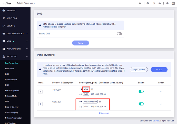

I think you might have misremembered the port forwarding rule.
We conducted the test using Flint v4.8.3.
In your scenario, we will need to add this port forwarding rule for it to take effect for WireGuard clients:
This is because the original port forwarding rule only matches traffic coming in via the WAN zone.
When a WireGuard client connects, its packets arrive on the wgserver interface which belong to WireGuard Server zone, so they don’t match the WAN zone and the forward never triggers.
To fix this we will need to add a port-forward that uses the WireGuard Server source zone.
That’s what I thought, I also on had UDP only. I thought maybe I needed to add a route rule instead.
Routing rules should not be able to assist with DNAT.
Unless routing is added on the WG Client side, allowing traffic destined for Flint 2 WAN to bypass the WG VPN and go directly through the ISP.
I see, but in the case example I provided above the internal IP would be my LAN gateway (example 192.168.11.1) to access the LAN from the WG VPN correct? And also add 443 for SSL?
Or just to forward to the docker server’s IP address?
