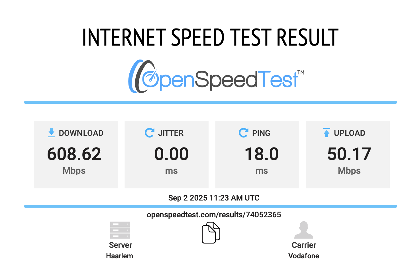

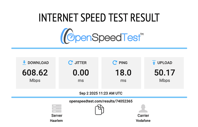

Flint 2 (4.8.0-OP24) 5 Ghz WiFi upload speed capped around 60-90 mbps
Just run the Speedtest directly from your client device, to compare:
  1. Connected to your ISP Modem/Router;
  2. Connected to Flint 2
Yes, I ran https://mylocalrouter:8888 (impressive results for my local WiFi connection) and https://openspeedtest.com (as well as https://speed.cloudflare.com) (insufficient results for upload speeds and packet loss). I did not realize at first that the local openspeedtest tested the connection between router and client.

[  5]   0.00-10.01  sec  1.06 GBytes   909 Mbits/sec                  receiver
iperf Done.
Connecting to host 192.168.8.174, port 5201
Reverse mode, remote host 192.168.8.174 is sending
[  5] local 192.168.8.188 port 50422 connected to 192.168.8.174 port 5201
[ ID] Interval           Transfer     Bitrate
[  5]   0.00-1.01   sec   112 MBytes   934 Mbits/sec
[  5]   1.01-2.01   sec   112 MBytes   936 Mbits/sec
[  5]   2.01-3.00   sec   111 MBytes   935 Mbits/sec
[  5]   3.00-4.00   sec   112 MBytes   938 Mbits/sec
[  5]   4.00-5.00   sec   112 MBytes   938 Mbits/sec
[  5]   5.00-6.00   sec   112 MBytes   936 Mbits/sec
[  5]   6.00-7.01   sec   112 MBytes   937 Mbits/sec
[  5]   7.01-8.00   sec   112 MBytes   938 Mbits/sec
[  5]   8.00-9.00   sec   111 MBytes   937 Mbits/sec
[  5]   9.00-10.00  sec   112 MBytes   938 Mbits/sec
[  5]   0.00-10.00  sec  1.09 GBytes   940 Mbits/sec                  sender
[  5]   0.00-10.00  sec  1.09 GBytes   937 Mbits/sec                  receiver
iperf Done.
Thank you for your detailed testing.
The test results seem somewhat unusual—merely switching the roles of server and client caused a significant drop in upload speed...
We'd like to further confirm:
  1. Does the low upload speed to the internet occur on all Wi-Fi clients, or only on some devices?
  2. What is your contracted ISP speed?
  3. What is the model of your ISP modem?
  4. Have you tested the non-op 4.8.2 firmware? Is the Wi-Fi upload speed normal?
I don’t think it’s that unusual. The pattern is that if a WiFi-connected device initiated the connection, then the upload speed becomes slow. If the LAN-connected device initiated the connection, it’s fast.
  1. All WiFi clients tested (MacOS and Android)
  2. 500 Mbps symmetric
  3. Don’t have this information available right now
  4. Have not tested; does it require me to reset my config?
Change all your passwords (WiFi, admin panel, etc) to ‘admin’
Generate a backup of your configuration.
Send the backup to GL-iNet (support@gl-inet.com) saying the password and the steps to reproduce the error.
They should load the backup and reproduce the error.
Sorry for the late reply.
In theory, you shouldn't need to reset the configuration since this is a lateral migration.
However, you can also back up the configuration file via Luci and choose not to preserve the configuration during migration to avoid potential issues.
