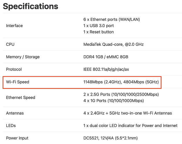

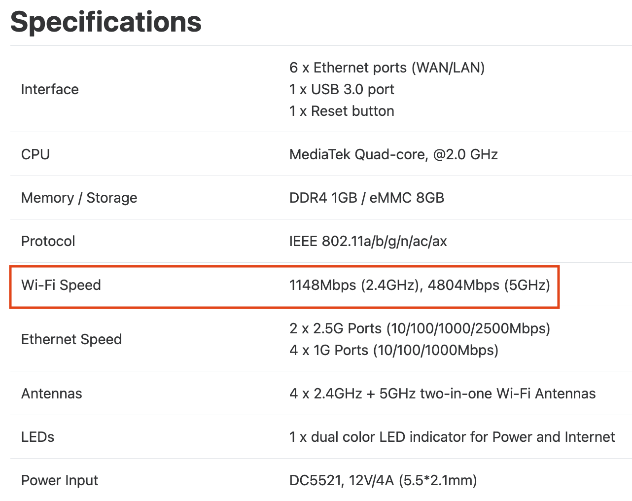

Could just be some quirk in the OP24 firmware, because the specs suggest much higher speed. But was hoping someone from GL-iNet could provide guidance, so I can do targeted experimentation.
Yeah, those specs are based on the firmware using the MediaTek SDK. I'd love to see some real numbers on how op24 compares... there's more than a few posts I've read that rave about it but nothing with benchmarks. Oh well.

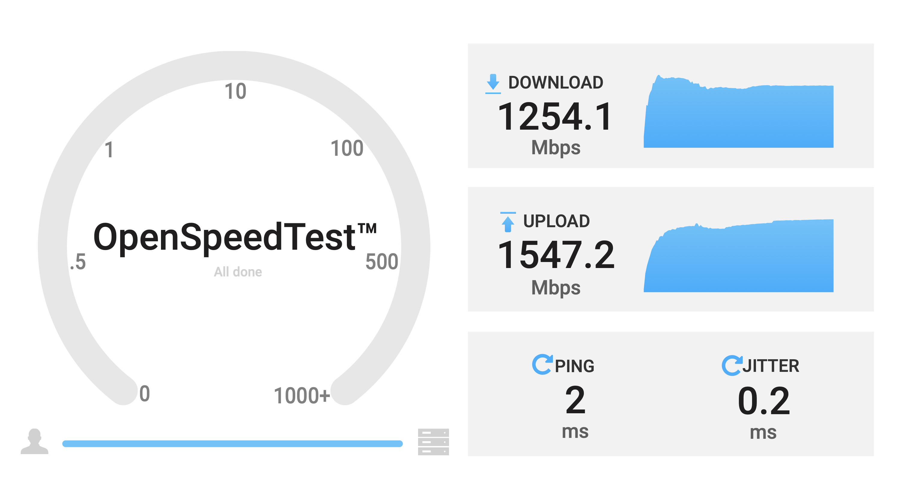

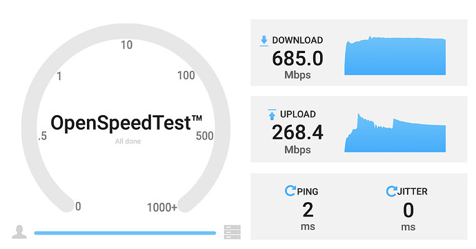

Yes, the Flint 2 is connected to the ISP modem via Ethernet cable. The results from OpenSpeedTest are impressive:

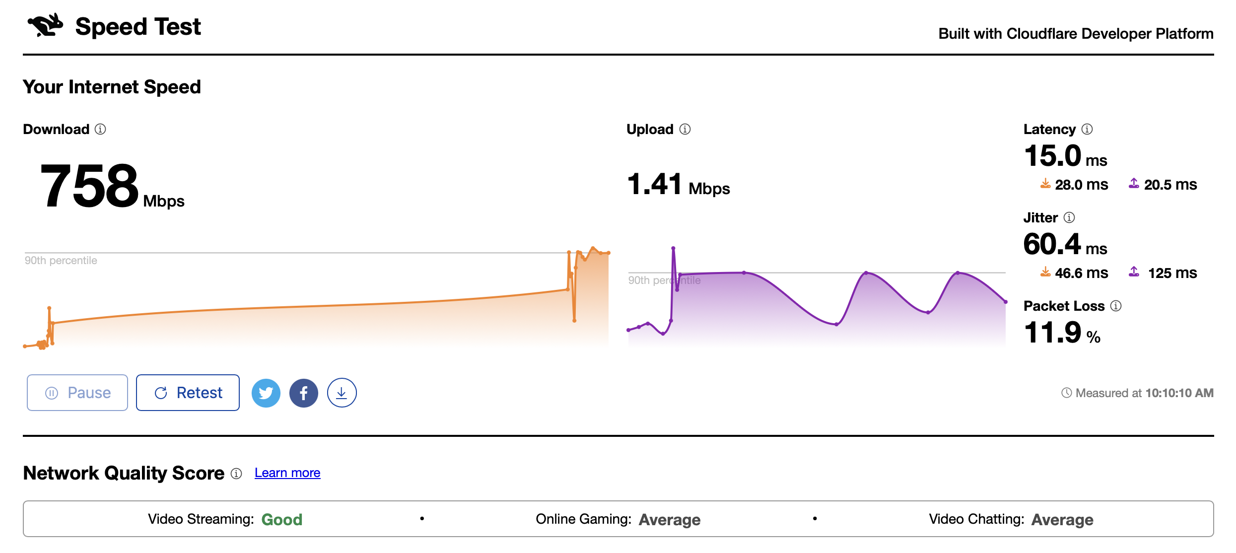

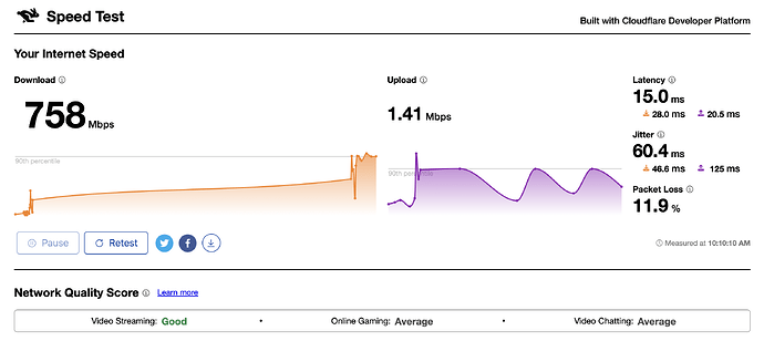

This is 6x the upload speed advertised by my ISP (and I can live with 685 Mbps compared to the official maximum of 1000 Mbps). From a client (2.5G LAN port), I only get a small fraction of the upload speed via the Cloudflare speed test (Cloudflare server is located approx. 60km from me within a metropolitan area):

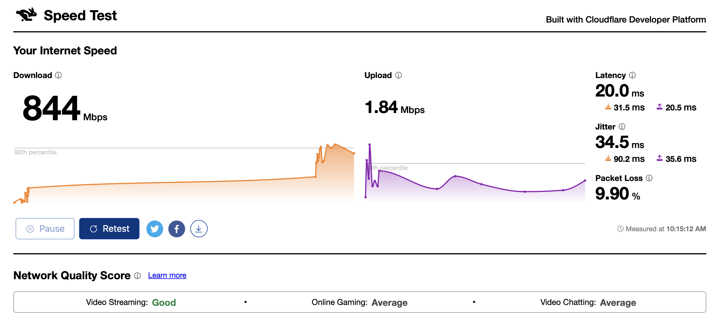

Please also note the high percentage of packet loss. For comparison, this is the result for a wireless connection (5 GHz, client located right next to the router), which looks better than the wired connection, but still has abysmal upload speeds:
So it seems the issue is between the WAN interface and LAN devices in general.
Update: I am beginning to doubt Open Speed Test a bit, since it displays speeds (especially upload speeds) way beyond anything my ISP ever advertised:
Okay, so that clarifies that those particular OpenSpeedTest results are coming in from one of their WAN-side servers. @will.qui & I are stating locally hosting OpenSpeedTest on the Flint v2 itself is the proper way to bench Wi-Fi <-> Flint v2. That attached link also has a note on how to use the Flint v2 with iperf3 as a daemon if that's more your preference.
To your concern: I wonder if your ISP provides 'burst' traffic for short periods? Mine does. There's also Ooka's Speedtest for another WAN-side test if you don't mind the fact they log results.

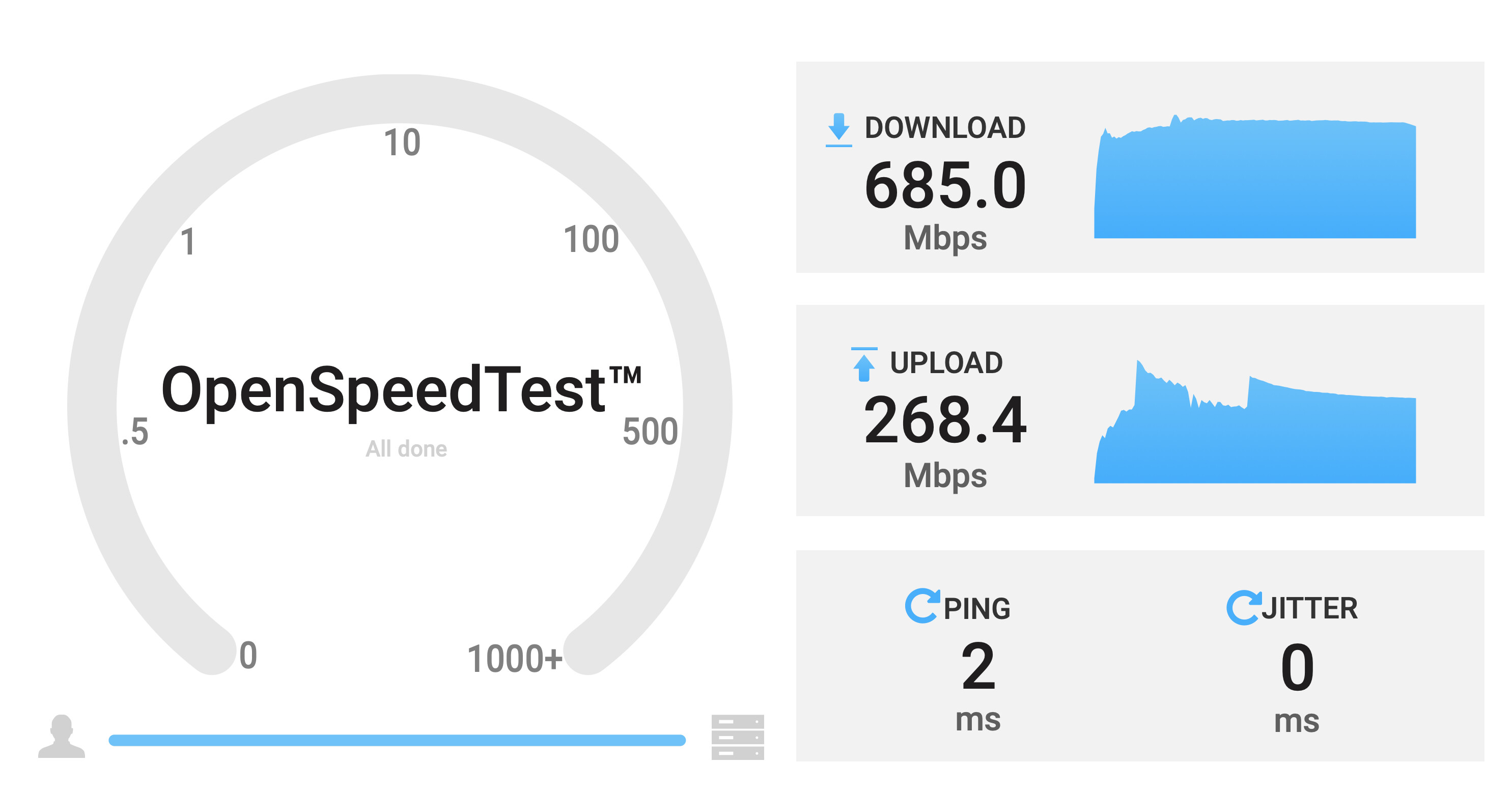

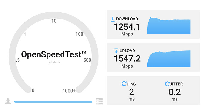

I installed the Open Speed Test script as instructed and use it locally via nginx (port 8888) on the Flint 2.
Okay — so that I'm not again mistaken — is this the WLAN's 5 GHz WiFi client <--> 192.168.8.1:8888 result below on v4.8.0-op24? If so keep in mind I don't really use Wi-Fi so IDK if this is the maximum either of your Wi-Fi endpoints is capable but I'm impressed. That ping rate is better than I expected & the jitter is near non-existent.
Yes – but I misinterpreted the results. I thought this was the connection between Flint 2 (WAN interface) and the Internet. If I understand your post correctly, Open Speed Test tested the connection between my router and my client?
Correct. You are 'locally hosting' an installation of OpenSpeedTest on your Flint v2, ma'am! What you're looking at are the the rates of your WLAN (Wireless-LAN (Local Area Network)).
