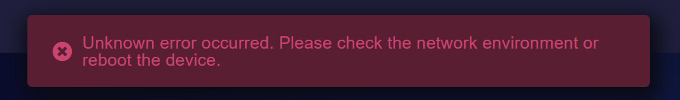

Flint 2 4.8.3 Unknown error occurred. Please check the network environment or reboot the device
if i login to the Router, or if i refresh any page within the GUI (F5) i get this error coming up:
The router seems to work just fine. There is nothing in the logs about any error.
I don't have anything installed or modified. Only things are internet conncetion, wifi, VPN setup and parental control.
If i open the console in a browser and login or refresh a page, it show this message:
*Uncaught (in promise) *
Object { type: "unknown", message: "Method not found", code: -32601 }
I don't know. it this means anything or is related to the error message.
Does someone else had this error? What can i do to get rid of that?
Factory reset does not helped. Normal and uboot tried.
Try to access in private / incognito mode. Clear browser cache in regular mode if that works. Try another browser.
Tried Brave, Firefox and Vivaldi. Also on 3 different devices, cache deleted and incognito mode.
Still the same message coming up.
I've reset my Flint 2 again (uboot)., setup internet, wifi, vpn and parental control.

Normally this error can also be caused when the connection with the router was lost.
Perhaps you experience something I saw on a other issue here, did you used a backup or kept settings between op24 to non op24 builds?
Then the firewall config has the fw4 set which is wrong and breaks with vpn policies.
This can crash the full dhcp server.

It is not known to me, what I recommend if that happens is checking the logs or via a other device which still has access, you could also setup a static ip on your pc or phone to regain control over the web ui in case the dhcp server dies.
It could also be that the router gets out of memory especially with adguardhome and alot of lists this easily can happen.
Did you try to update the preinstalled packages by chance? This error often happens when lua gets an update - and breaks then.

When i got that error message shown in the UI, i had full control over the web UI and have full access to it. As said, the router just works perfectly. The only hint was the error from firefox console.
All clients within my network have a static ip.
I use the router in a real "basic" config. No adguard or any other fancy stuff is running.
I also did not uninstalled or disabled anything.
@admon
No. I am running the stock 4.8.3 without any updates on preinstalled packages.
Could you please follow the guide and share your device with us via GoodCloud so we can check it remotely?
