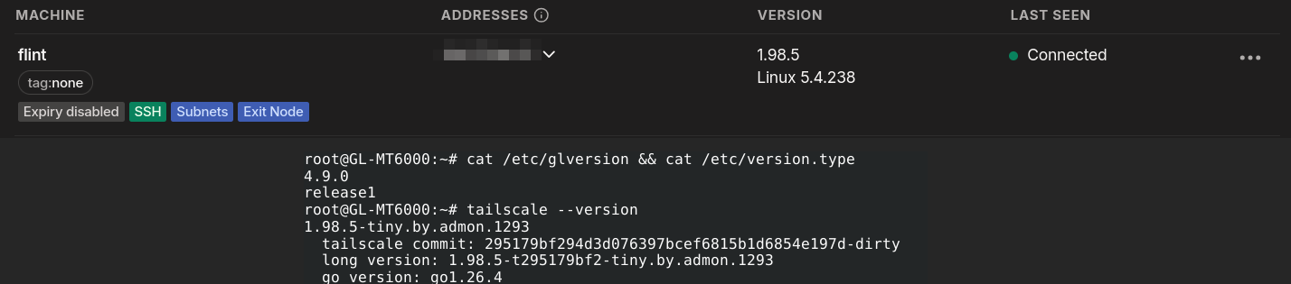

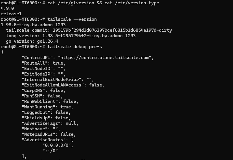

We tested this feature using the built-in Tailscale package on Flint 2 v4.9.0 Release, and it appears to be working correctly:
image690x58
It also appears to work correctly after updating with @admon's script:
image690x47
Perhaps you could try restoring the gl_tailscale script to its default version and see if that resolves the issue:
