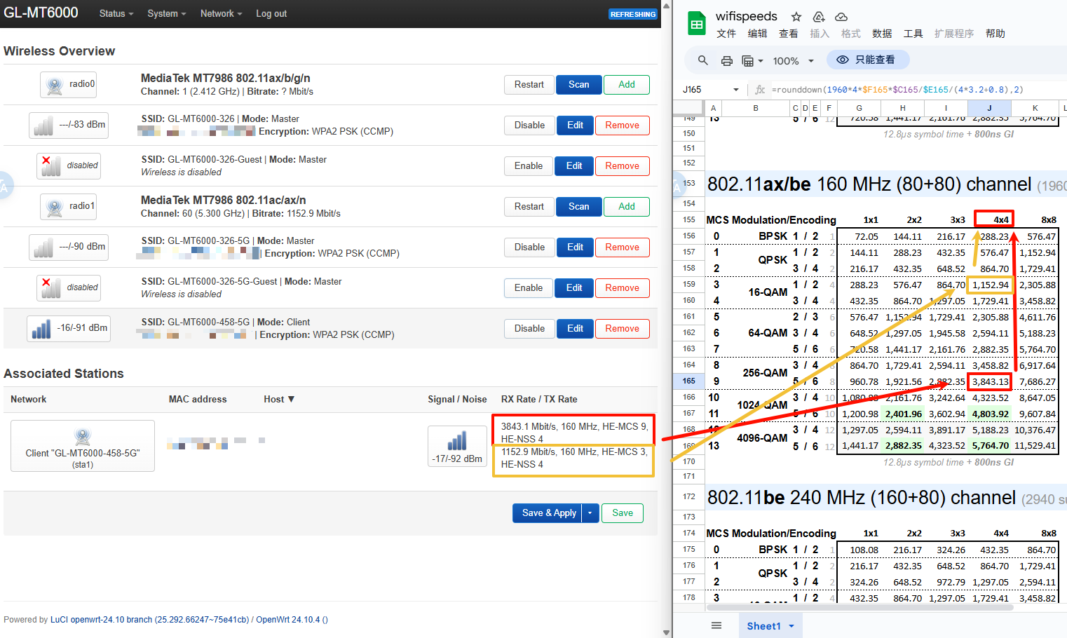

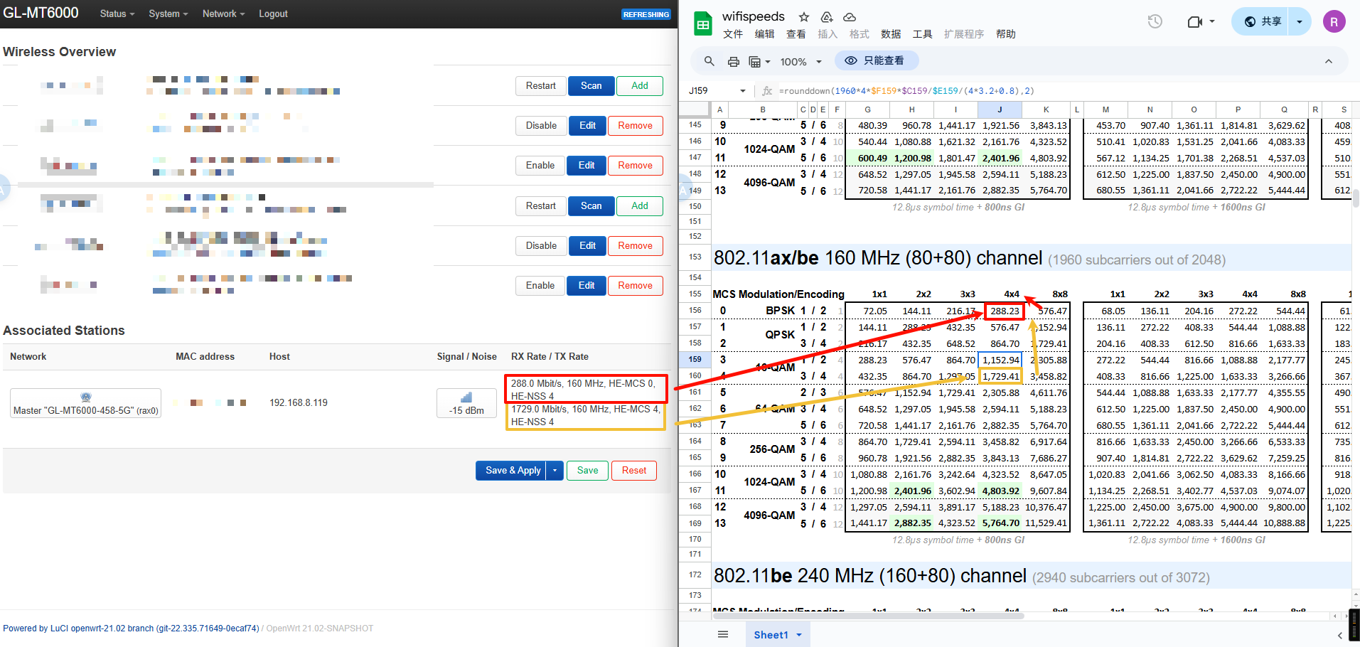

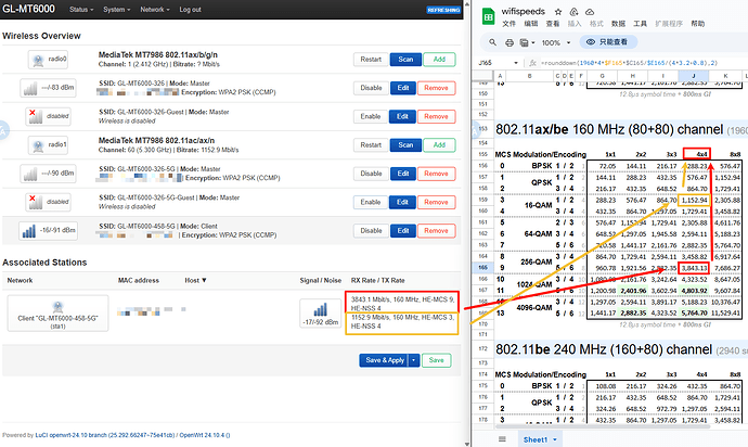

My question: When two Flint 2 units are connected together over Wi-Fi (one as AP and the other as Extender or WDS), does the STA (client) side operate in 4×4 or 2×2?
More specifically:
Does the Flint 2 STA interface really support 4×4 MIMO at 160 MHz,
or is the STA-side limited to 2×2 MIMO due to mt76 driver behavior?
In real-world tests, the negotiated PHY rate between two Flint 2 units never exceeds 2402 Mbps, which corresponds to 2×2 / 160 MHz, not 4×4.
Several community tests and discussions indicate that MediaTek Filogic 830 + mt76 driver only supports 4×4 in AP mode, but limits the STA mode to 2×2.
**So the core question is:
Is the Flint 2 STA (Extender/WDS client) truly 4×4, or is it operating as 2×2?**
This is extremely important to know, because:
If STA is 4×4, the AP ↔ Extender link could reach 4804 Mbps PHY.
If STA is 2×2, the maximum is 2402 Mbps PHY, even if both devices are 4×4-capable.
I would be very grateful for a clear, technical confirmation:
Does the mt76 driver in the Flint 2 allow 4×4 MIMO on the STA side,
or is it limited to 2×2 MIMO when connecting to another AP?
Thanks a lot for your assistance — this clarification will help me design the correct wireless backbone between two Flint 2 units.

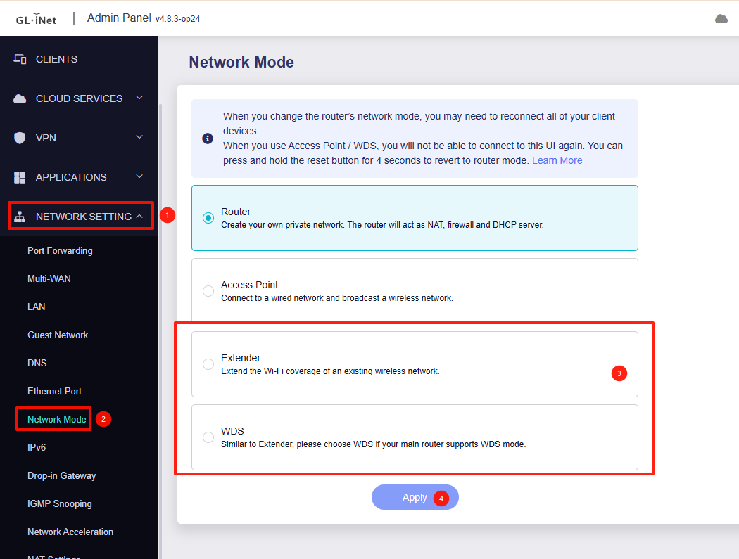

I got the other Flint2 and I am trying to set the second flint in WDS (client). Both the flint2 went throught a factory reset and the installation of the latest available firmware based on openwrt24. When I set the WDS client, I can’t browse the internet, the pages do not load. I also tried to set WPA2/WPA3 mixed, but nothing changed. I tried also to set WDS client on the second flint 2 using pure openwrt, but I had the same result. Connection established, but no browsing.
Is there anything that has to be done via the GL.Inet firmware to browse the internet via the WDS?
For configuring WDS mode through Luci on op24 and native OpenWRT, we recommend seeking assistance from the OpenWrt community, as this part of the codebase is outside our support and maintenance scope.
I did use the WDS functionality from GL Inet firmware, however it does not work. I can ping the websites, but I can’t browse the internet, I only see the main title of the website, but the page is not loaded.
What shall I do next to be able to browse the internet?
Is the main router also running stock firmware? If not, and if it's running op24 or native OpenWRT, the issue may be driver compatibility-related. Please try using stock firmware.
Additionally, does it work properly in Extender mode?
Both WDS and the extender will lose at least 50% of the bandwidth for devices connecting to secondary router via Wi-Fi.
However, wired connections, such as the one you want to use to connect your PC to the secondary router, won't be affected.
