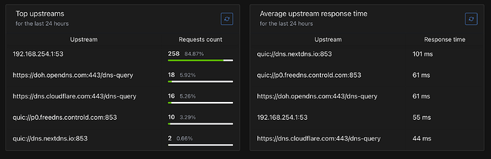

I double check myself and yes I have upstream from my isp but I can't find query logs which device or domain used my isp .
Over 90 days :upside_down_face:
So it looks like thats normal thing...

I thought I messed something up during AdGuard setup before finding this post.
Just to check I've cleared logs, disabled Tailscale (had it set-up running though AdGuard, thought maybe it was the culprit) - nope still majority of traffic ignores my upstream DNS servers.
