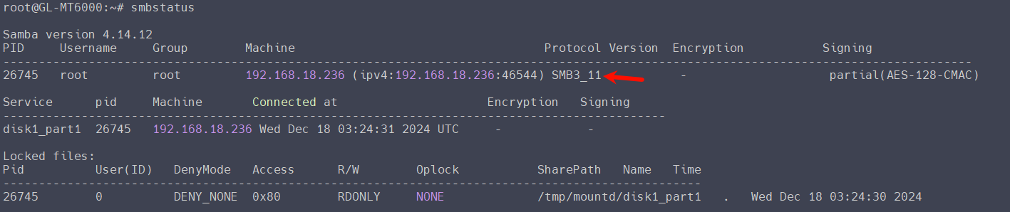

I'm using SMB3 protocol because I don't have any device prior to Windows 10.
From what I found, SMB3 refers to SMB3_11 variant on smb.conf:

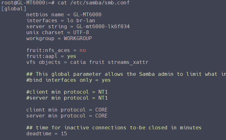

Update and clarify, after we detailed check, /etc/samba/smb.conf, server min protocol = CORE

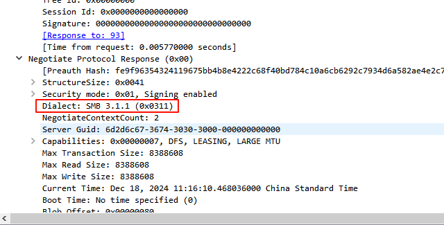

Although the configuration file is written CORE, actually, samba will automatically conduct agreement negotiation:
If the samba client supports SMB3, the server willl be upgraded to SMB3 even if the CORE is configured.
BWT, this is for better compatibility and performance.
