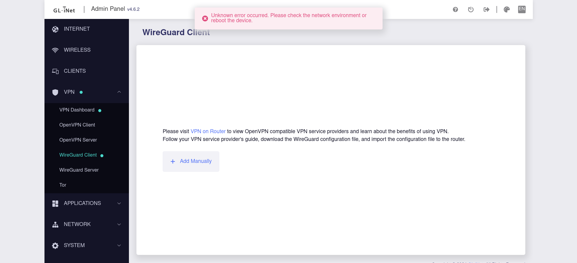

I'm having a similar problem with my Gl-iNet GL-MT 6000.
Kernel version: 5.4.238
I cannot create or access existing Wireguard profiles. I get the following error:
"Unknown error occurred. Please check the network environment or reboot the device."
I'm using the following firmware:
Version 4.6.2
Firmware Typerelease1
Compile Time 2024-06-28 09:59:09 (UTC+00:00)
