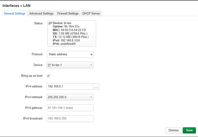

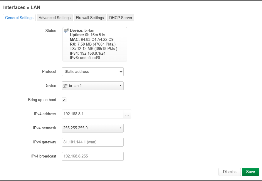

Can you show which interface is assigned on the wireless settings in luci?
It needs to be interface lan, not br-lan.1 or br-lan.
Since the vlan isn't a newly created interface this should work, on new interfaces the firewall zone input needs to be set to accept.
the interface lan has a child vlan device br-lan.1, hostapd/wifi always require a bridge to hook into or a child device from the bridge (a vlan device), the only thing I see you are missing is the keep up bridge checkbox being checked.
When you are done, also on the wireless part, restart the router because the MTK SDK is buggy on the luci part and sometimes only works properly after a restart.
From the vlan stanza I don't see really a issue.

Thanks to all who replied. It was wireless adapter bug indeed. Reboot helped

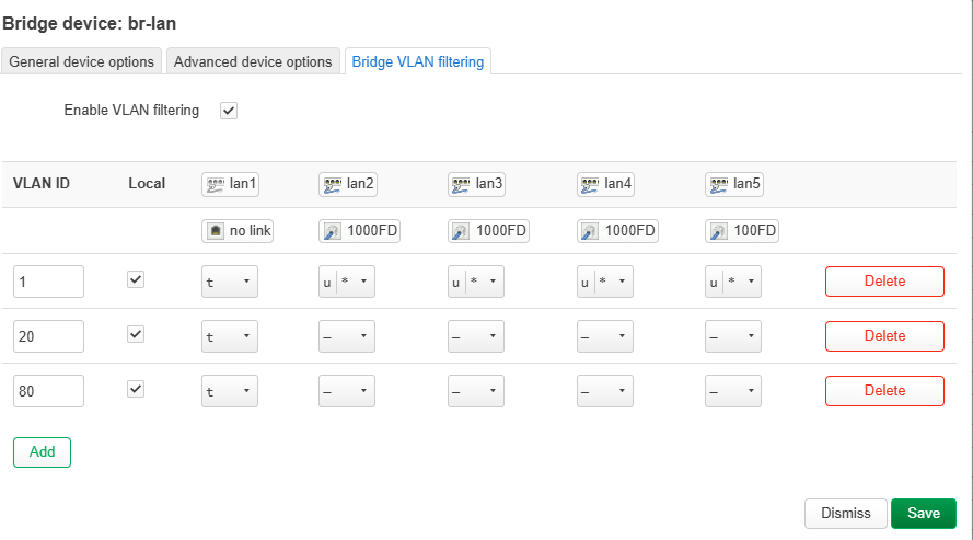

Could you share a photo of your vlan in luci?
This is the way I setup my VLAN’s on the version 4.7x firmware.
Also, be mindful of this apparent bug in the LUCI GUI when applying VLAN settings on the br-lan bridge device. Whenever I modify any settings on the br-lan bridge device, I have to ensure that the ‘Enable VLAN Filtering’ checkbox is not checked or it kills the br-lan network.
