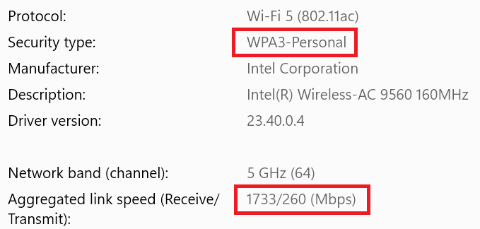

When Flint 2 is set to WPA3-SAE, the download speed link can reach the full speed but the upload link is limited.
Client A (1733/260 Mbps):

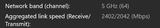

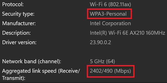

On Client "B", it can also reach the maximum download speed (2.4Gbps) but the upload is also limited at 490 Mbps
On WPA2, both download/upload can reach the full speed.
There is a clear difference on the upload speed when changing the authentication mode between WPA2 and WPA3

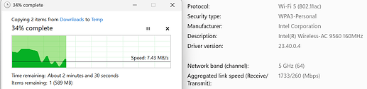

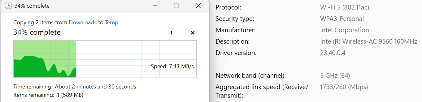

I also upload a file to Flint shared folder to keep the device active, before checking the link speed:

Yes, but the link speed should be:
  • Client A: 1733/1733 Mbps (and not 1733/260 Mbps)
  • Client B: 2402/2402 Mbps (and not 2402/490 Mbps)
When Flint 2 is set to WPA2, I can see the full speed.
When Flint 2 is set to WPA3, the upload speed is reduced as above (in bold)

On the first post I shared the screenshot of the link speed.
The link speed doesn't take into consideration the cache, hard disk speed, etc. It's the speed of the link.
When Flint 2 is set to WPA2 the link speed is at full speed.
When Flint 2 is set to WPA3, the upload link speed is reduced by 80%
