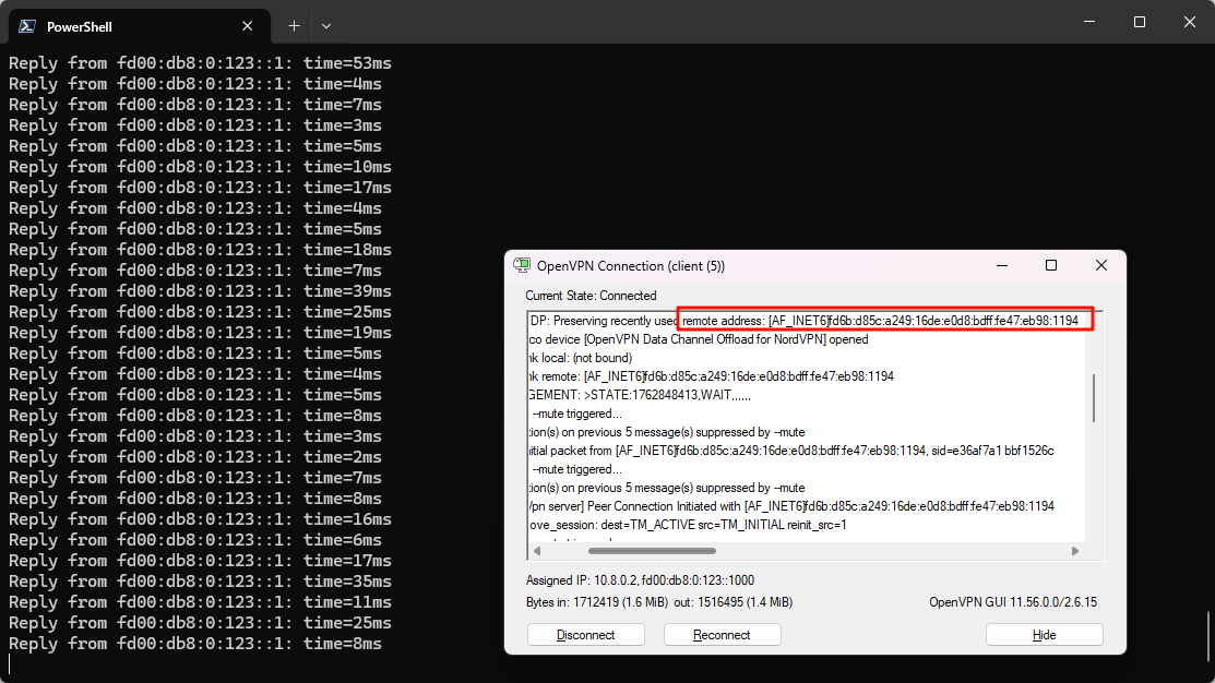

We tested this scenario using Flint 2 running firmware v4.8.3 and were not able to reproduce the issue.
When Flint 2 is configured as IPv6 enabled and an OpenVPN server, clients can:
  • Connect successfully over IPv6 addresses
  • Send and receive IPv6 traffic through the VPN tunnel

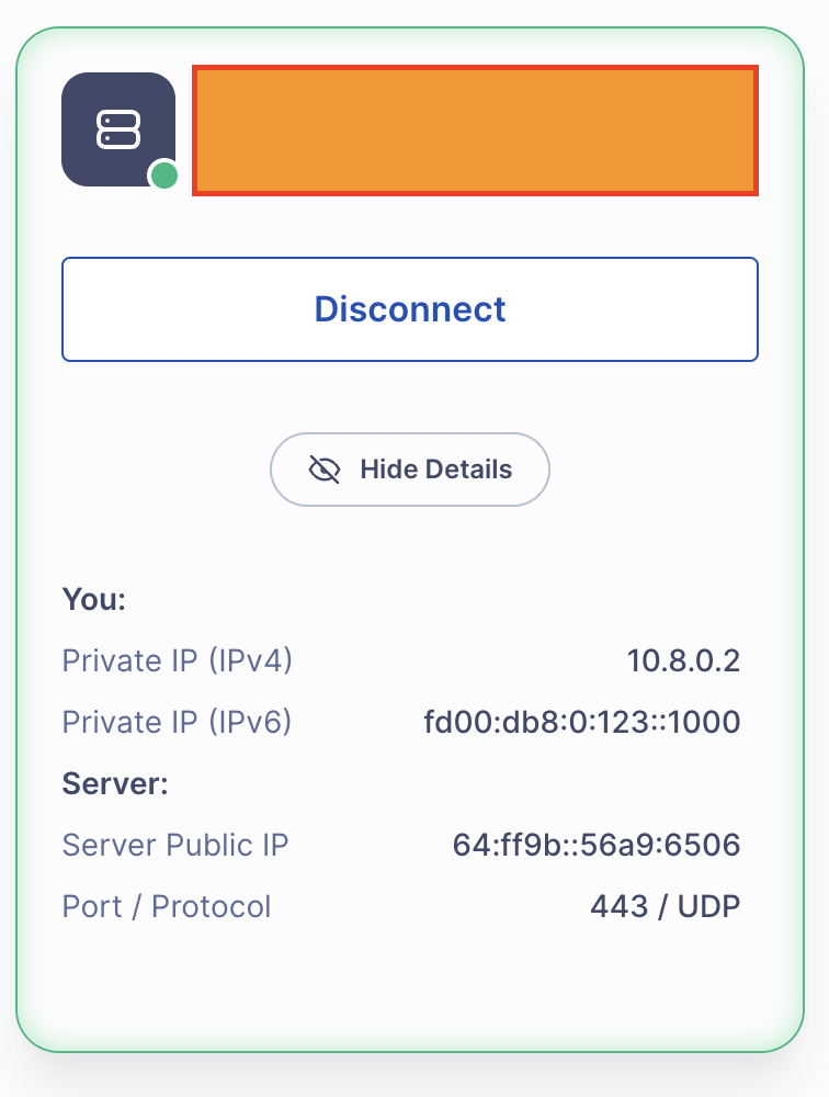

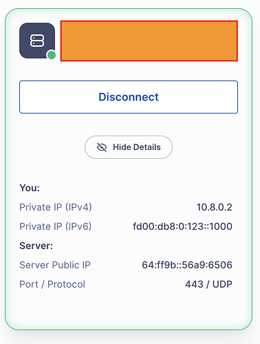

Could you please provide some screenshots to help us better understand the issue?
Regarding this, do you mean that the OpenVPN interface itself does not have an IPv6 address, or that when visiting an IP lookup website like What Is My IP Address, the IPv4 query shows the VPN server’s exit address, but the IPv6 query does not?
@will.qiu
I have not mentioned this before I am using OpenVPN Connect on MAC.
Yes you are right that IPv6 Public IP is not changing after VPN is connected only IPv4 is changing.
