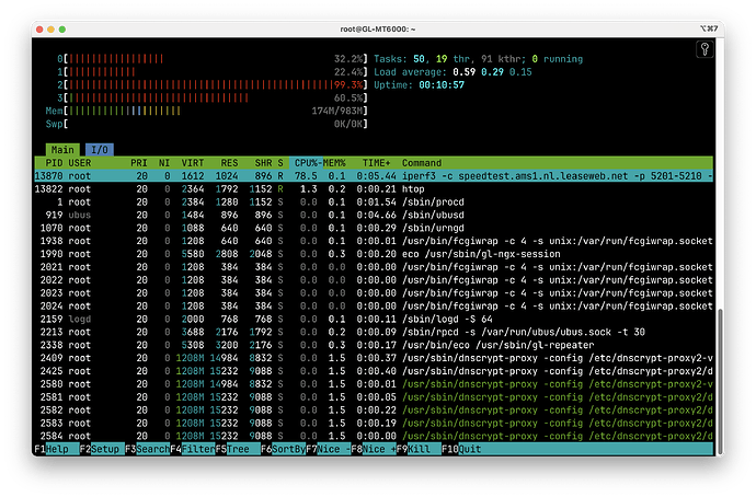

So, the Flint 2 is perfectly capable of routing close to 2.5Gbit (this is even over PPPoE with VLAN tagging), however performs worse when running iperf on the Flint 2 itself. This is not a huge issue of course, since we usually generate traffic from clients, but curious nonetheless.
Like I said upthread, I think this caused by something becoming CPU-bound. See the htop screenshot below made while running iperf. You can see iperf using roughly 80% CPU, but the load is much higher than just that iperf process. Also, all the bars are red, meaning that the time is spent in kernel threads. So I am still wondering if running iperf on the device itself somehow triggers a (routing?) path that is not hardware-accelerated.
