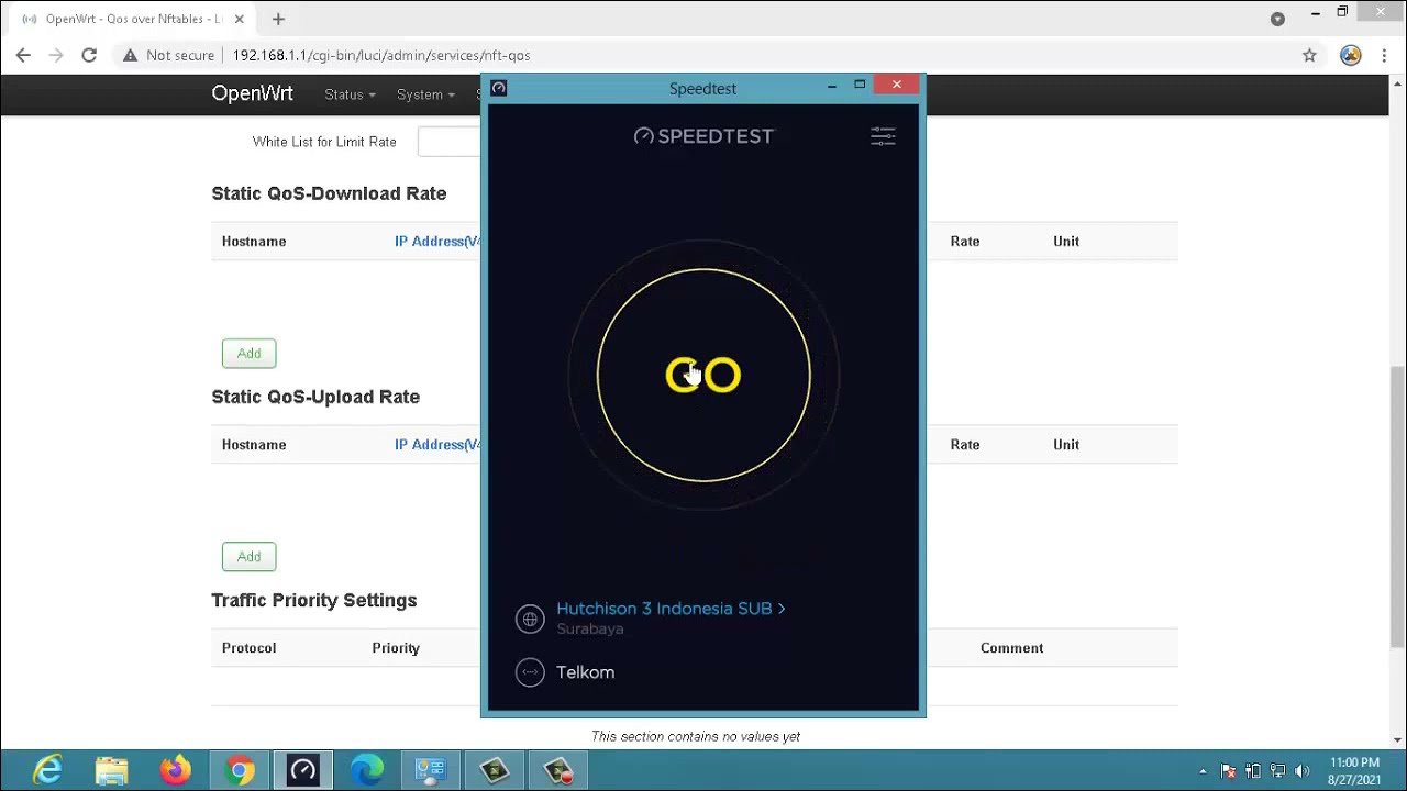

Can someone tell me how to prevent a client from accessing the Internet but still be active on the network?
I just found that in the video.
I found this in the video here:
I have no idea whether this is correct.
