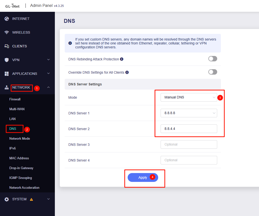

If pinging the domain name fails but pinging the IP address succeeds, this may indicate a DNS resolution issue.
Please try manually configuring the DNS settings.
Wow, it actually worked! Thanks a ton for the help.
