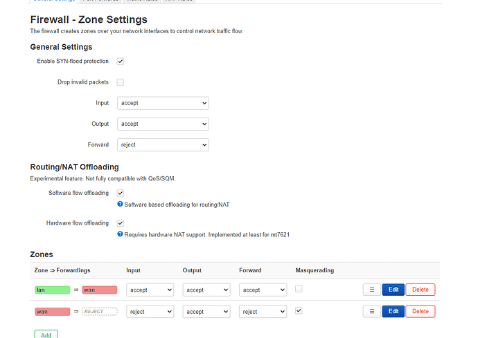

Is hardware and software offloading also enabled according to LuCi/Advanced settings?

Even though I enabled both hardware and software acceleration in LuCI, after rebooting the router, those settings reset back to disabled. Not sure why that’s happening.
