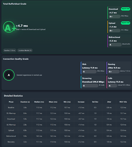

  1. LibreQoS Test Results:
    I just ran the test on bufferbloat.libreqos.com and, just like Waveform, I get an A+ grade.
    So, the SQM logic is definitely working correctly, keeping the latency flat... BUT only because I have capped the speed at 300 Mbps.
