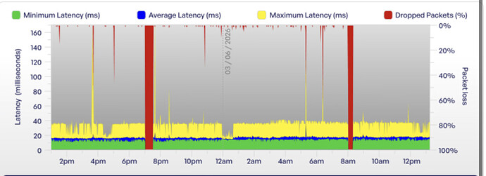

I have a broadband quality monitor running on the connection. It pings the WAN constantly.
The first big red bar was me upgrading the router from GL-iNet 4.7.7 to 4.8.4. You can see the packet loss at just after 5am and after 6am this morning.
Second red bar was me switching to the Virgin Media router.
As you can see, no packet loss at all since using the cable modem as a router.
