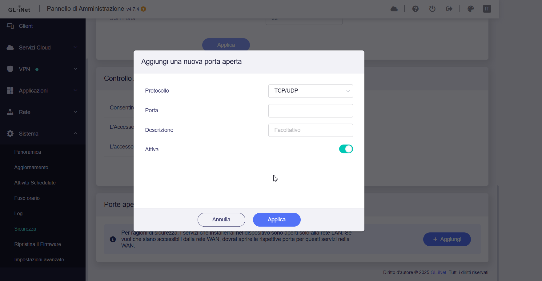

Ok, so it is not necessary for me to open the other ports in my list that require outgoing traffic, these 3 ports that I opened should make my device work (as soon as I connect it) correctly both incoming and outgoing. Bruce, I take this opportunity for another question, I noticed that in the "System-security" section there is another section "Open Ports on Router" (see photo n.2), what is this section for? I read the manual but I did not understand well in which cases it should be used, it seems similar to the "port forwarding" section but here instead you can only put the ports without IP address.
For example, here too I have to insert the same 3 ports that I opened in port forwarding 500,4500 and 22? Thanks in advance for the reply.
System - Security: the port that opens the router itself, such as http 80 / https 443 for GL GUI.
Network - Port Forwarding: forward the port of the LAN client in the router.
If "port forwarding" is set up, the forwarding rule has taken effect at that time. No longer needs to be configured in security.
