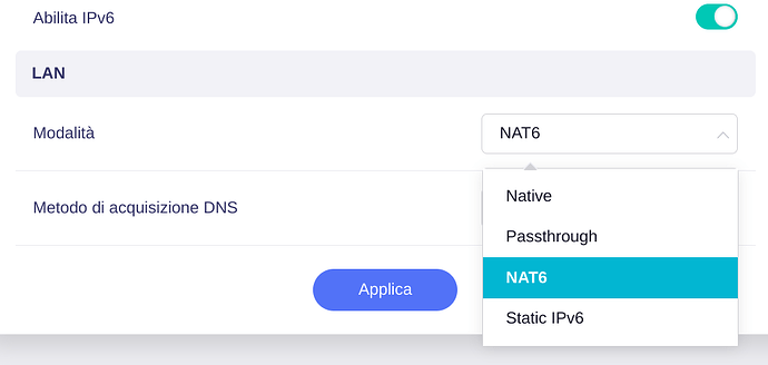

Does your ISP support IPv6 ? Do you enable IPv6 in Flint 2? I have experience that if I disable IPv6 in Flint 2 the PPPoE dialing takes forever to connect to.

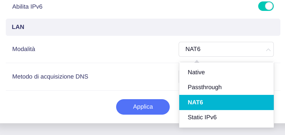

Ok, I’ve put Native also, let’s see what happens.
Sound strange to me that enable/disable ipv6 can fix the issue with pppoe, but let’s check
Thank you!
