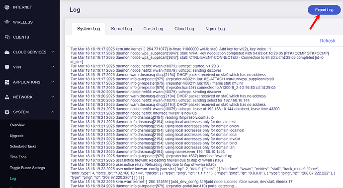

  3. Please export the syslog logread.tar file, and PM me again.
