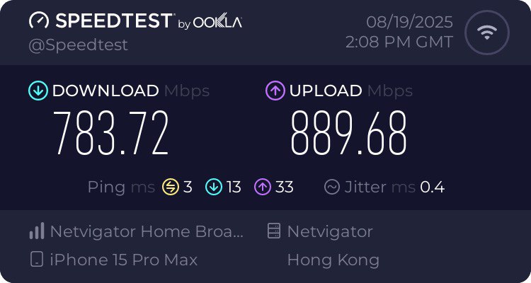

My ISP offers 2gbps download and 1gbps upload, the ISP modem has 2 LAN ports, one is 2.5gbps and other other one is 1gbps.

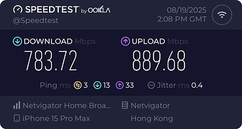

If Flint 2 connects in 1g LAN port, the speed is normal no matter wired or wireless, almost reaching 1000mbps:

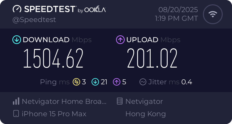

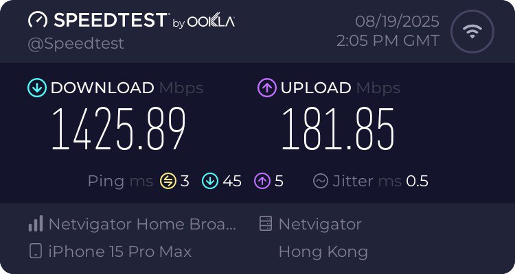

But if connects to 2.5g LAN port, speed is normal for wired connection (1800/900), but the upload is unexpectedly slow in just ~200 for wireless connection:
All of the above were tested in the same environment, cable connects to 2.5g WAN port of Flint2, and the distance between the devices and the router remained unchanged. The wireless devices are iPhone 15 pro max and OnePlus 10Pro, result are almost the same.
I think the problem is not related with the ISP, modem and the cables, may I know what should I do so that the upload speed under wifi could reach the expected speed in around 900? Or this is a nature for Flint2 because of the bandwidth?

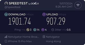

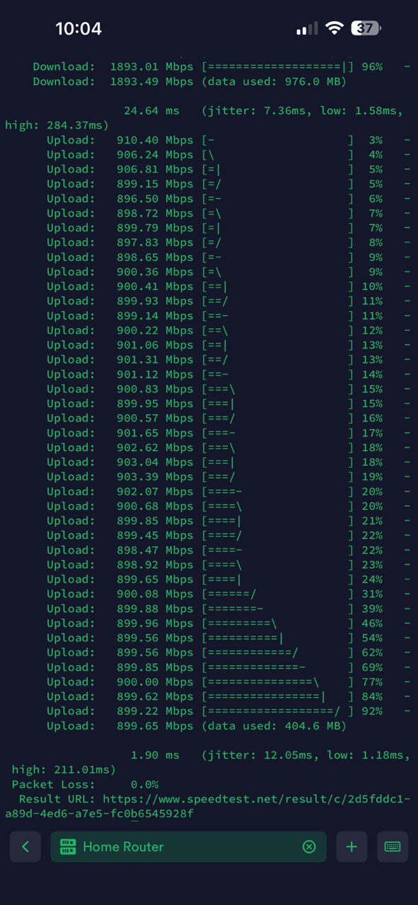

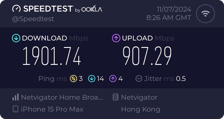

I don't have the PC, but if iphone connected Flint2 by using 2.5g USB type C LAN adapter, it could reach 1900DL/900UL as below:
And by the way, the firmware using is ver.4.8.0 (without op24).

Well, that's better than nothing but the stated negotiated link speed (2.5 Gbps) doesn't guarantee the same when it comes to throughout (1.9 Gbps) as you just demonstrated. That benchmark might be even better with a proper Intel 2.5 or 5 GbE NIC & Cat 6 cable.

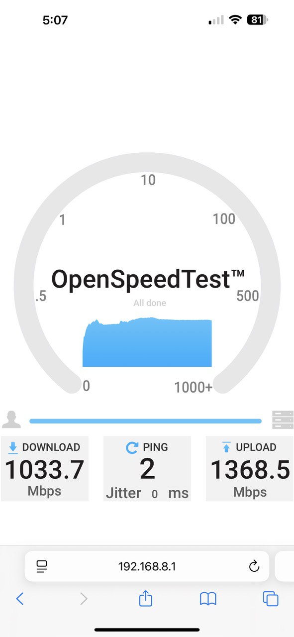

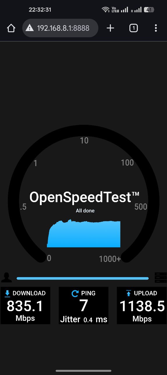

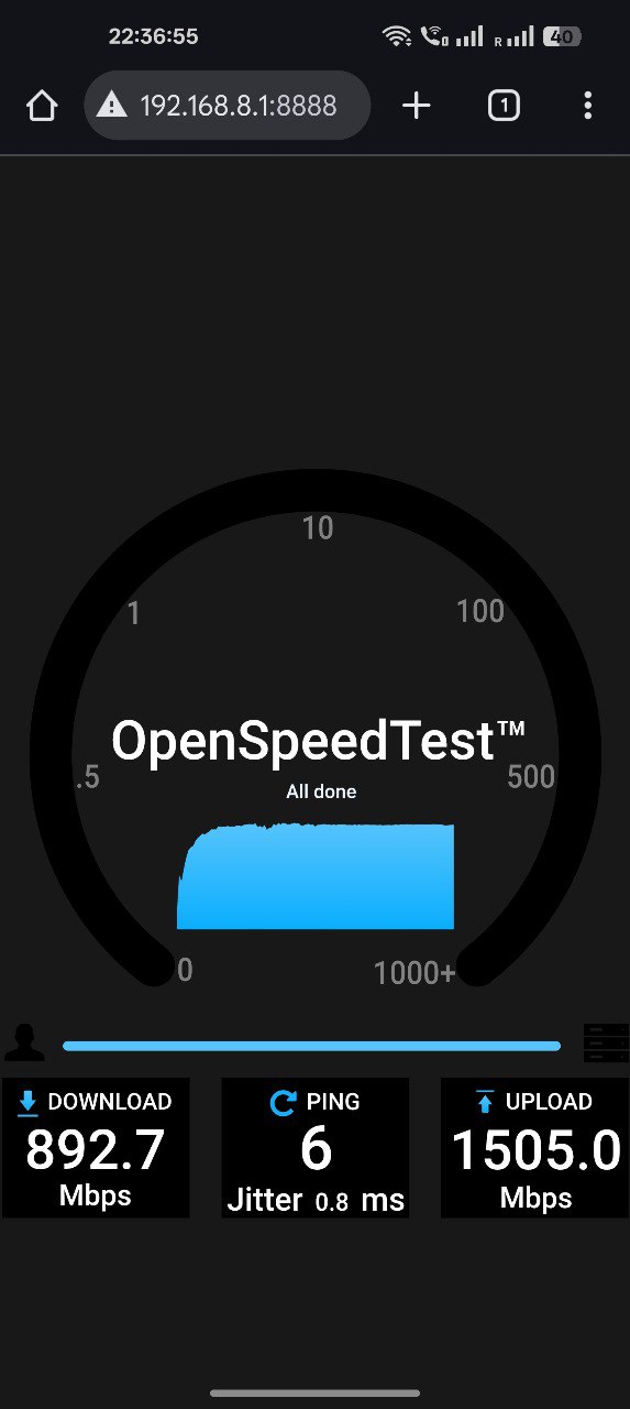

You can deploy an OpenSpeedtest server on your router and test the speed on your WiFi client,
to locate the issue is in the WAN or the LAN side.
iPhone 15 Pro Max
OnePlus 10 Pro
