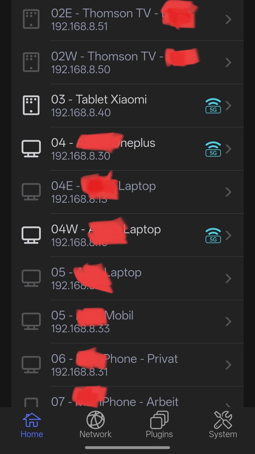

I thought I had my first router working perfectly with ProtonVPN; all my clients show Proton’s IP and DNS on 'whatsmyip' and ControlD leak tests. However, the GL.iNet app shows all clients as being 'outside' the VPN. I’m certain they are actually connected, but the fact that the app and web interface show them as unprotected proves that my setup isn't quite right yet, even on the router I thought was fine
Regarding what I said before: 'the GL.iNet app shows all clients as being 'outside' the VPN. I’m certain they are actually connected, but the fact that the app and web interface show them as unprotected proves that my setup isn't quite right yet, even on the router I thought was fine.'

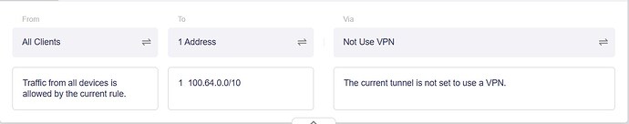

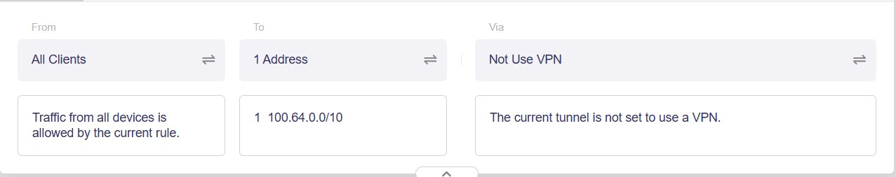

I found the reason: PrivadoVPN configurations use the same IP range as Tailscale, which is 100.64.x.x. For testing purposes, I created a VPN policy to make Tailscale connections bypass the VPN. Apparently, this confused the router and caused all VPN connections to appear as if they were 'outside' the tunnel, even though whatsmyip and Control D confirmed they were still behind a VPN IP and using encrypted DNS servers."
Now I'm wondering if this IP range overlap will cause any other kind of problems for the router when it confuses Tailscale IP addresses with VPN addresses. By the way, Proton uses a different IP range.

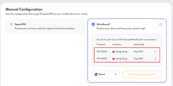

This was the most frustrating discovery. I have two Flint 2 routers in different locations.
  • The Problem: If I connect both routers to the same Privado WireGuard server using the same account, the entire network collapses. Internet drops constantly, DNS fails, Tailscale disconnects, and I lose remote access to the routers.
  • What DOES work:
  • Using OpenVPN (same account, same server).
  • Using WireGuard if the routers connect to different servers.
  • Using WireGuard if the routers use different Privado accounts on the same server.
Conclusion: The instability only occurs when two different origins (routers or clients) use the same account to hit the same WireGuard endpoint. While NordVPN handled this flawlessly, Privado/Proton seem to have strict session or routing conflicts when a single identity tries to multiplex on the same server.

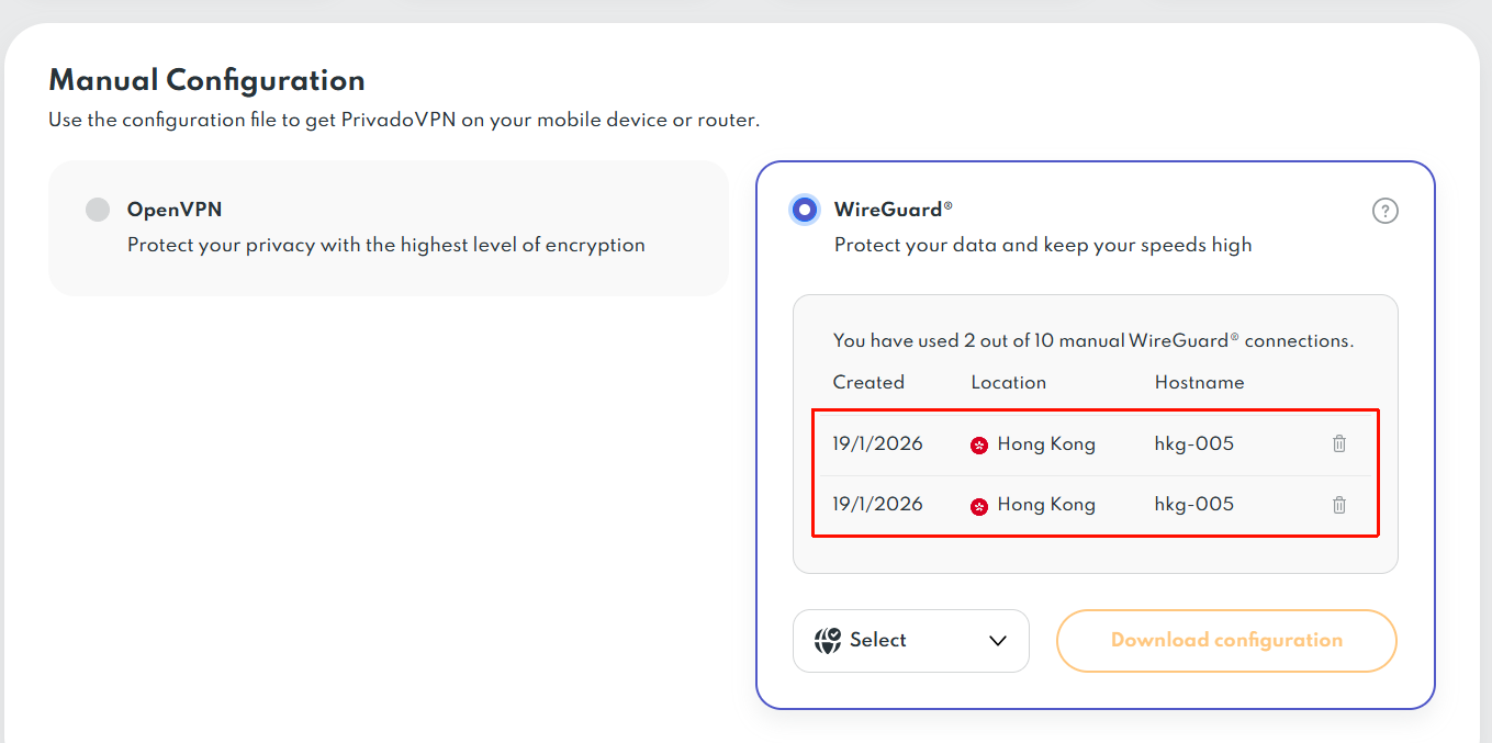

Edit 18.01.2026: I just learned from Privado support that a WG config file can't be used simultaneously from two different routers, even though with NordVPN this was never a problem. Mystery solved and everything works! Hope my find outs will Help somebody. Next project: creating a VLAN for my IoT devices. Let's go!
  1. Regarding the DNS behavior, I don't fully understand the complete picture yet. However, if NordVPN is working as expected while others are not, it is very likely an issue specific to those individual VPN providers.
  2. As for the Privado WireGuard issue: yes, please do not use the same VPN profile on multiple clients simultaneously, as this will cause conflicts.
    Instead, you can generate separate, unique profiles for each of your two clients within the Privado dashboard. Even if both profiles connect to the same server, they will function correctly as long as they are distinct.
Thanks Will for your answer!
Regarding the WireGuard configuration profiles: I understand now. Privado explained the same thing to me yesterday. However, I should mention that this was never an issue with NordVPN; I was able to use the same WireGuard profile simultaneously from different routers without any problems. It seems NordVPN handles session multiplexing differently than Privado or Proton.

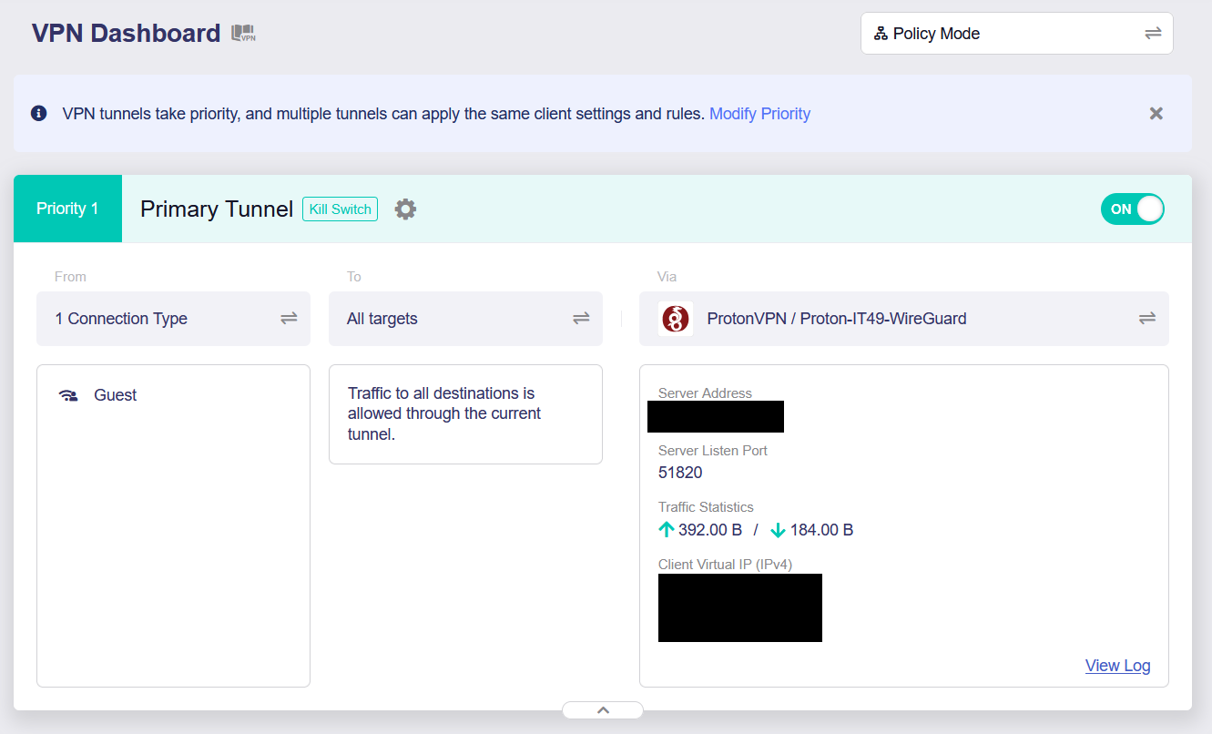

I have a much simpler setup in place, and I am having some issues that I hope somebody in this thread could help me fix.
I have a GL-BE3600 (Slate 7) router updated to firmware 4.8.1 with a simple tailscale setup redirecting all traffic on a remote exit node and a manual DNS set.
However, I would like to have the Guest WiFi clients to be redirected via a ProtonVPN WireGuard or OpenVPN tunnel.
At the moment, this is the behaviour of my router:
  • ProtonVPN tunnels disabled → Guest Wi-Fi nodes are routed directly to my local ISP router (no tailscale, no Proton)
  • ProtonVPN OpenVPN enabled via policy mode → Guest Wi-Fi nodes are routed directly to my local ISP router (no tailscale, no Proton); the ProtonVPN tunnel is completely ignored;
  • ProtonVPN WireGuards enabled via policy mode → Guest Wi-Fi nodes have no access to the Internet.
Is there any simple way I can have all clients in the main LAN (Wi-Fi and Ethernet) go through Tailscale and the Guest clients going into a ProtonVPN tunnel?

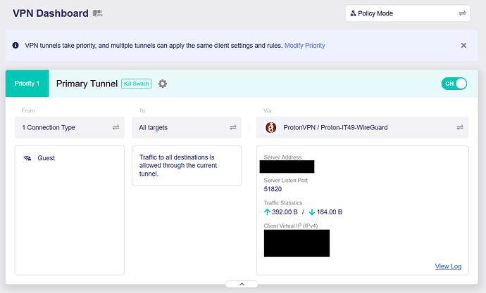

Find below example of policy mode configured with ProtonVPN WireGuard.
I’m not familiar with your setup or specific situation but I think you should be able to achieve this via LUCI/network/firewall/zones/guest. Try it but backup first :wink:
