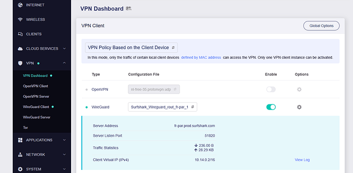

-I changed the VPN configuration to Policy Mode and I selected this mode:
Based on the Target Domain or IP
And then I created a new rule to exclude NETFLIX and OQEE from the VPN encryption:
