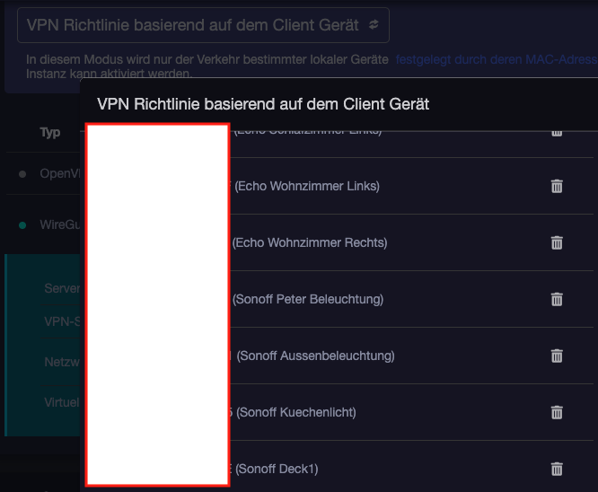

Hello, I have 2 Amazon Echo speakers, both of which are excluded via the VPN policy (based on the client device). So that both devices should “not” use VPN.

If I switch on Nordvpn-VPN (but devices are “excluded” from the VPN), they work.

When I enable the VPN, only the Amazon Echo devices lose their connection to the router and no longer have an internet connection. All Amazon Echo devices have been properly excluded in the VPN policy, but they still lose their connection when the VPN is enabled (absolutely no issues with other devices). If I turn off the VPN, they work again immediately. I've also tried different DNS settings, but that didn't help either.
