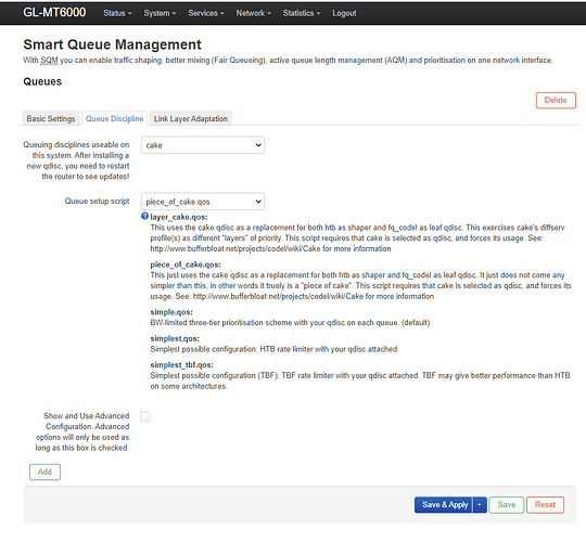

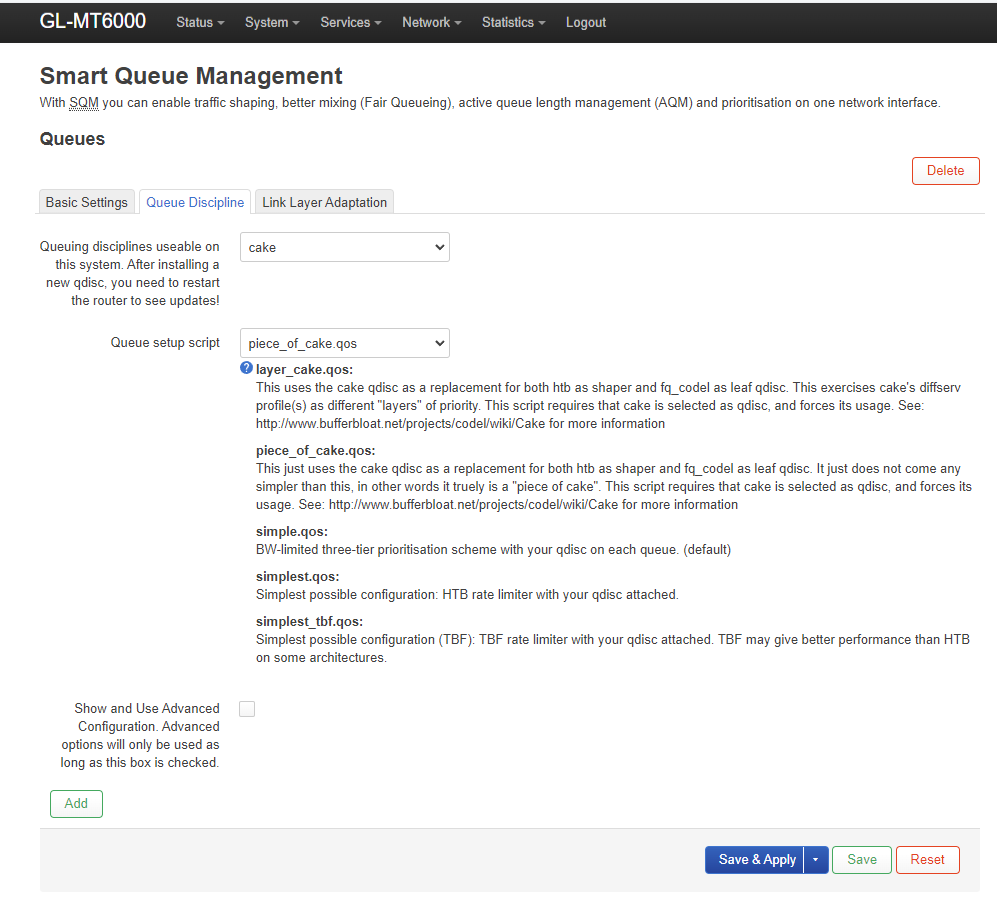

Did you try SQM? It’s a game changer on latency during heavy loads
Thanks, here's my result which is worse.
What have I done wrong?
Edit: I left NAT acceleration on.
But with it turned off I got a really low download speed https://www.waveform.com/tools/bufferbloat?test-id=93a3bcb4-5be5-486d-91c8-2999c36b4118
Got a similar result elsewhere too, but on the first too I got around 660mbps before it dipped to under 200mbps.
Switched SQM back off and NAT acceleration back on and got my speed back.
Reboot the router after turning it off. The speed I use is: line speed - 7%
The speed will be a little bit lower but latency should be way better.
Ohh you’re using pppoe :thinking:
Yes using pppoe with openreach fttp 1000/115
