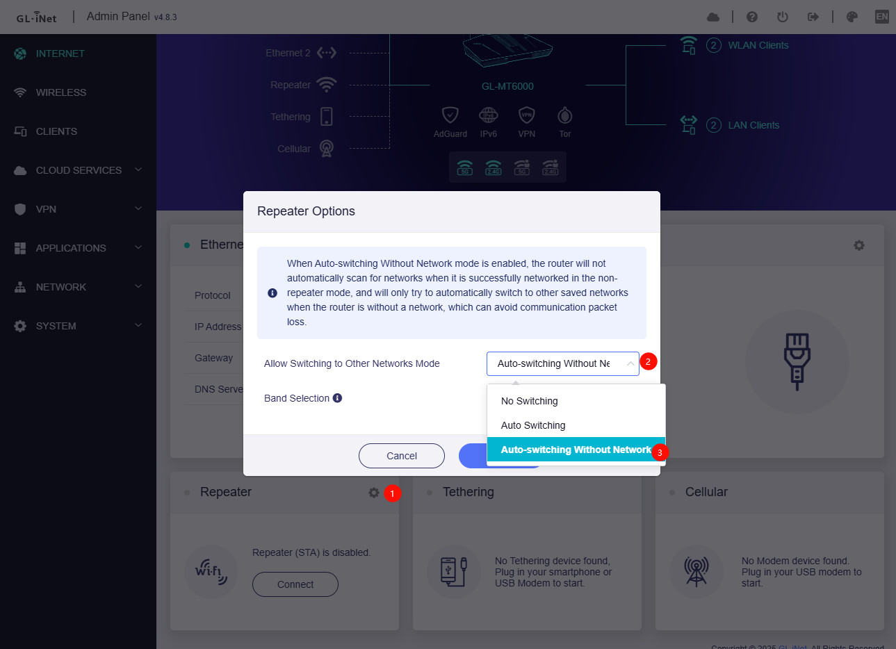

I resolved my wifi issue by doing a factory reset and starting from scratch.
I also had to make sure the repeater fallback feature was disabled while my main Internet was working. The router kept scanning for Wi-Fi hotspots to connect to and disrupting the Wi-Fi network.
No AQL was necessary. SQM worked fine after that.
Ironically, the only reason I ditched my previous router was specifically to get failover, because my ISP (Astound) kept having multi-hour and multi-day outages. So, aside from shopping for a new ISP, I also wanted site-wide redundancy. I kept the WAN-over-WiFi failover enabled on the router with the intent of turning on the phone hotspot as needed and expecting the router to make use of it automatically. But this jitter issue makes that unacceptable.
So now I’ll just have to enable this feature manually as needed. Unfortunate but still better than the total lack of that option with my previous router.
I am glad to tell you some good news.
When the Ethernet (ISP WAN) works properly and the repeater is not connected, please select this option Auto-switching Without Network, the repeater will not continue to scan WiFi; the repeater will only start scanning when the Ethernet is disconnected.
In this way, when the repeater is enabled and the repeater is not connected, automatic scanning is stop and will not occur and affect the own WiFi.

It looks, however, that as of version 4.8.3 of the GL.iNet software for the Flint 3 (GL-BE9300), this option is gone. I suspect that is because the new firmware automatically supports this option:
From…
https://dl.gl-inet.com/release/router/release/be9300/4.8.3
  • Optimized the switching logic of the Repeater; when the internet is already connected, the repeater will not scan for available networks to ensure wireless communication quality.
I just updated. With preliminary testing of only several minutes, the lag I was seeing before seems to be gone. (I have not, however, tested that failover still works when all WAN sources with higher priority all fail.)
Thank you for the prompt reply to this thread, and thanks to the engineering team for making the Repeater failover just work without this latency issue, without having to select an option manually.
Yes, originally the three options here were likely to cause confusing to users, so this logic will hide and persist always, in further firmware version.
