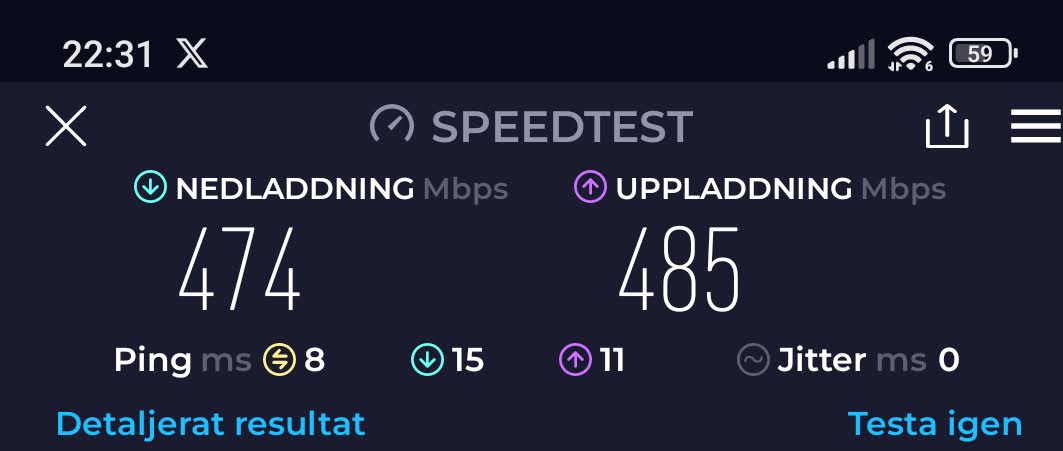

It's been like this for a while now and I'm not technical enough to figure this out on my own so decided to make a forum post
1gig symmetrical connection having strange speed differences to the internet over wifi, an issue I didn't have with previous router
wifi 6, channel 36, 160mhz, connected link on my phone at 2401Mbps
speedtest on phone
comp
speedtest on computer seconds later (same test server)
this is reproducible, always this way to this and most other speedtest servers

Phone: Xiaomi 11T Pro (2107113SG)
flashed op24 without keeping settings
first against one of the speedtest servers that always seems to work over wifi using Flint 2:
(the one that was mentioned working in my first post)
then against the one in my other posts:
moments later on computer to same server as other posts:
speedtestcomp
and again against the first test one
op24 seems to go higher over wifi than 4.5.8 and 4.6.2 to the servers I'm experiencing issues with but still weird speed differences compared to the other router for some reason

4.5.8 first firmware I had when booting up if I recall correctly, started realizing something was wrong just a day or so after setting it everything up, tried all the "regular troubleshooting stuff" like channels bands DFS signal strength network accel etc etc, issue persisting whatever I did
so flashed 4.6.2 when it was in beta
tried all of it again, no changes
was told by dev to try op24
only thing that gave different results, instead of locking to ~500 op24 locks to ~570 to the regular fail server and different slightly higher results towards other servers where I had problems
flashed back to 4.6.2 stable but that's exactly the same as the beta 4.6.2, flashed back to op24 after doing tests on stable 4.6.2
not daily driving Flint 2 for the time being, last few weeks only been swapping when people come by to let me test other devices
will try another firmware when I have more free time
I did have a VPN running at first but my phone and computer were excluded of course, performed exactly the same as clean firmware installs (same issues)
but just to be safe I switched back to my ASUS router and did all future Flint 2 tests on clean installs
