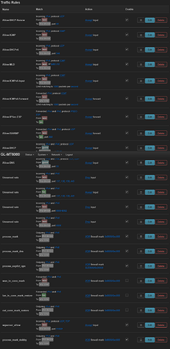

Can you show a screenshot of luci and their firewall zones?
Please also include the global rules.

I'm only allowed to post one attachment at a time...
Here's the other one.
Try setting input to drop on general settings :+1:

Also i did a look to a traffic rule: allow_wgserver set this one to protocol udp only.
If tcp was set or icmp aswell it could still reply with a icmp reply that it was unreachable this is what the scanner sees, wireguard only uses udp thus does not doing the replying :slight_smile:

Thanks for the help, it appears that it's caused by the allow_wgserver rule defaulting to udp and tcp as @xize11 said. Changing that rule to udp only still allows me to connect to the server but still appears as stealth according to ShieldsUp :+1:. Turning the Wireguard server on and off again resets this though so it seems a bit irritating.
