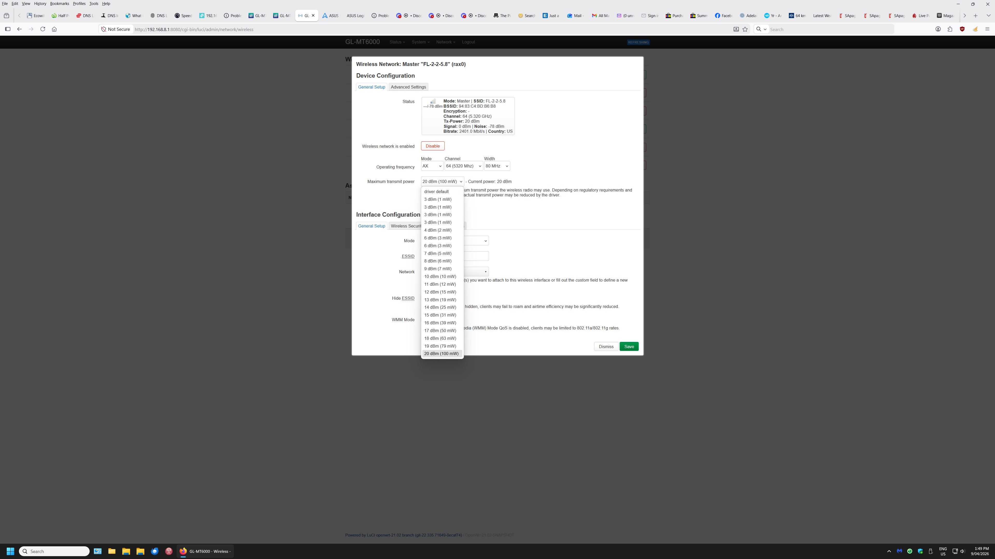

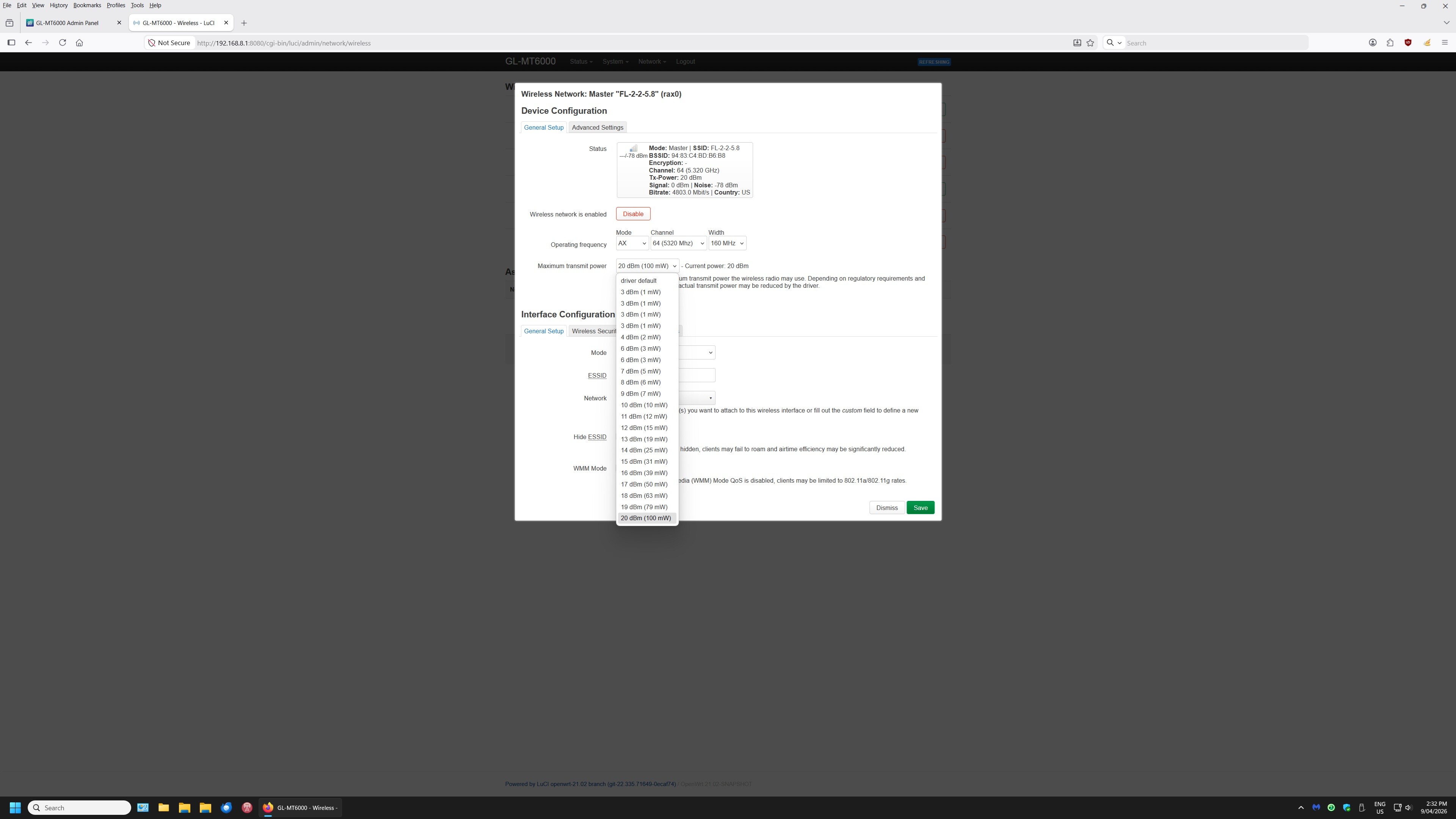

Im sure in previous firmware versions luci gave me the option of 1w max in the pull down table with country set to panama. Now 100mw is the highest regardless of cointry code.
Maybe I waa dreaming.
At my parents’ house we have two Wi-Fi access points installed with this configuration, while at my place the maximum signal I can get is 24 dBm. I’m based in Italy and I’m using 4.8.3 op24.

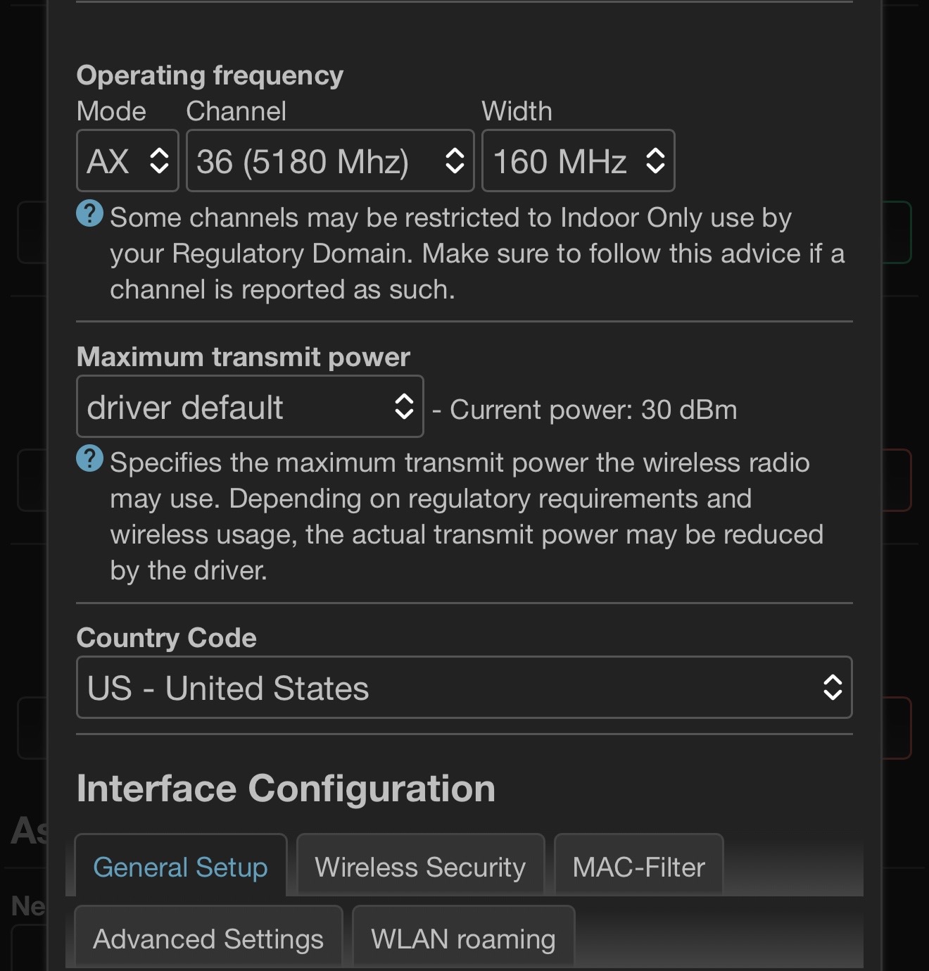

Ok so I checked, its available when selecting US for me as the 30dbm option.
Try changing width to 160? Also which software version?
Stock v4.8.4
