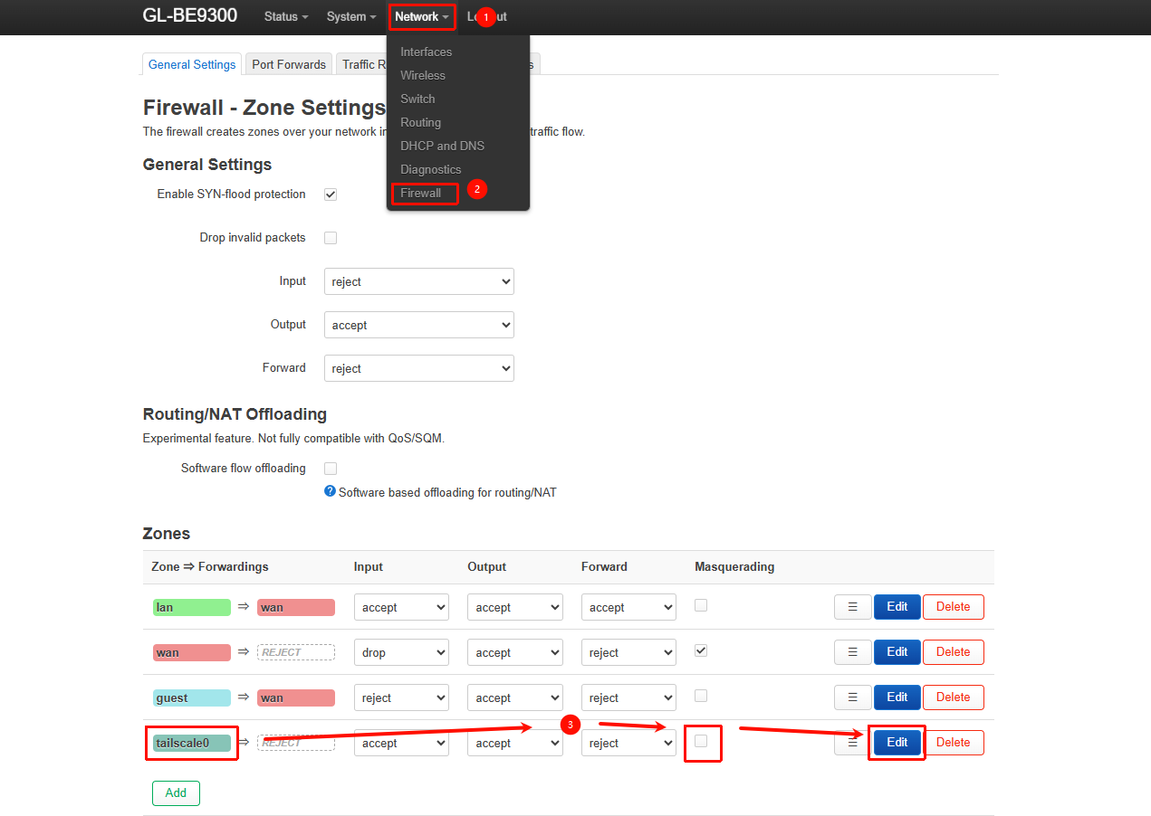

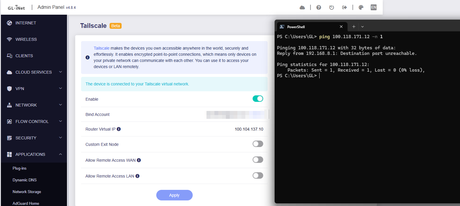

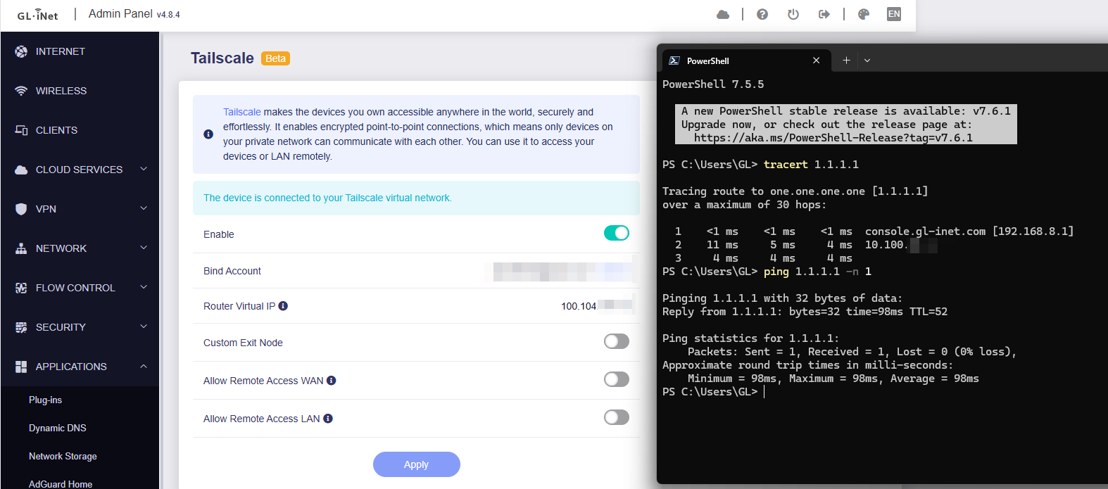

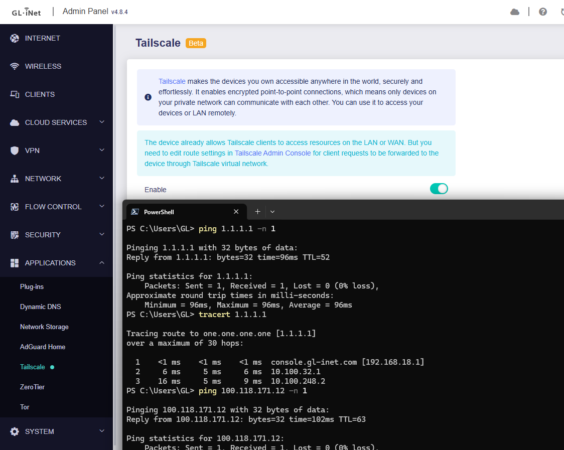

We tested locally using BE9300 v4.8.4, and it appears that enabling Tailscale does not affect LAN devices’ access to the internet.
Regarding the IP rule you mentioned, there are already other rules that match earlier and allow traffic to exit normally via the main routing table.
(When VPN is not enabled, LAN traffic matches the 6000: from all fwmark 0x8000/0xf000 lookup main .)

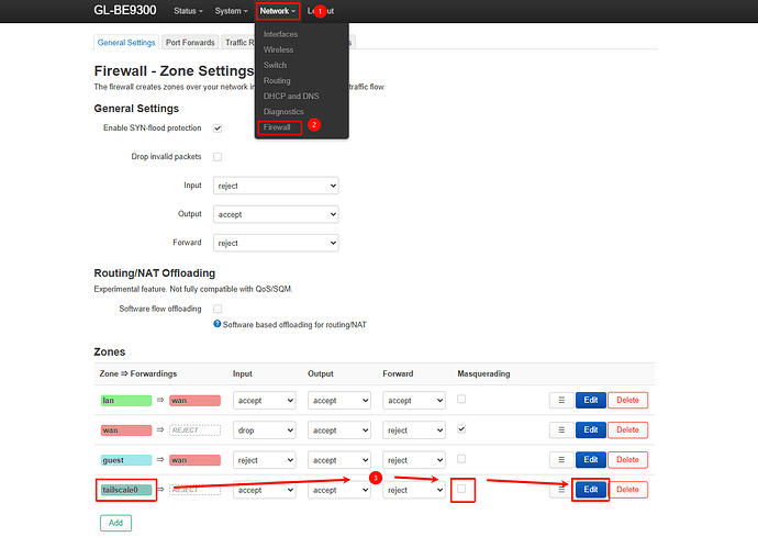

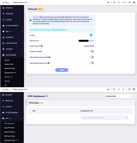

Limited to one upload per post restriction so have to reply again, but here’s my Tailscale and VPN Dashboard.

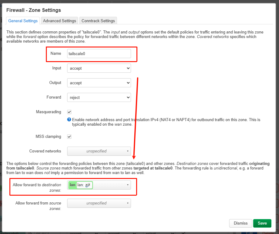

I have a hunch that perhaps Will toggled the “Allow Remote Access LAN” (based on his screenshot stating “The device allows Tailscale clients to access resources on the LAN or WAN”…) which is likely causing it to route to 6000 allowing internet access to LAN devices. But toggling “Allow Remote Access LAN” shouldn’t be a prerequisite to getting this working properly since keeping “Allow Remote Access LAN” off is a valid use case. We may not need to access home LAN devices from outside Tailscale and may just want Tailscale local devices to communicate with each other.
As mentioned earlier, there are other rules in the IP rules that match LAN-to-WAN traffic.
The blackhole rule is only used in rare cases to prevent IP/DNS leaks.
If you want LAN devices to remotely access resources in the Tailnet, you need to enable “Allow Remote Access LAN” and approve the routes in the Tailscale Admin Console.
Otherwise, remote Tailscale nodes won’t have a return route to send responses back.
Also, this option does not affect internet access for LAN devices.
If you want LAN devices to access Tailnet resources without enabling “Allow Remote Access LAN”, you can enable Masquerading for the tailscale0 zone in LuCI → Network → Firewall, and allow forwarding from the tailscale0 zone to the LAN zone.
(We’ve added a one-click option for this in v4.9.)
Without enabling “Allow Remote Access LAN”, it only applies to scenarios where remote Tailscale nodes access the router itself.

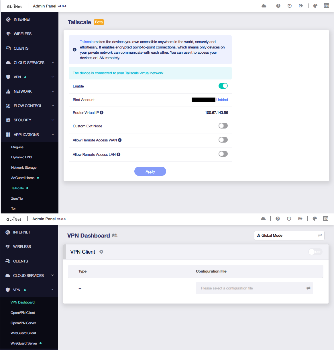

Noted, but for this issue, I’m not trying to access my LAN devices remotely nor trying to have my LAN devices access Tailnet resources. I suppose we can leave this part out from the conversation since I don’t think its relevant to the issue I’m running into.
I may have had my initial cause with the 9910/9920 blackhole rules incorrectly diagnosed. So I will start describing my issue from scratch to see if you can assist on what’s actually going on here as I am clearly confused now.
I’m running into a scenario whenever my Tailscale is turned ON, my local LAN devices (connected to the router) internet stop working. The moment I turn OFF Tailscale, my local LAN devices can connect to the internet again.
I’ve tried playing around with the sequence and listed my rule list.
