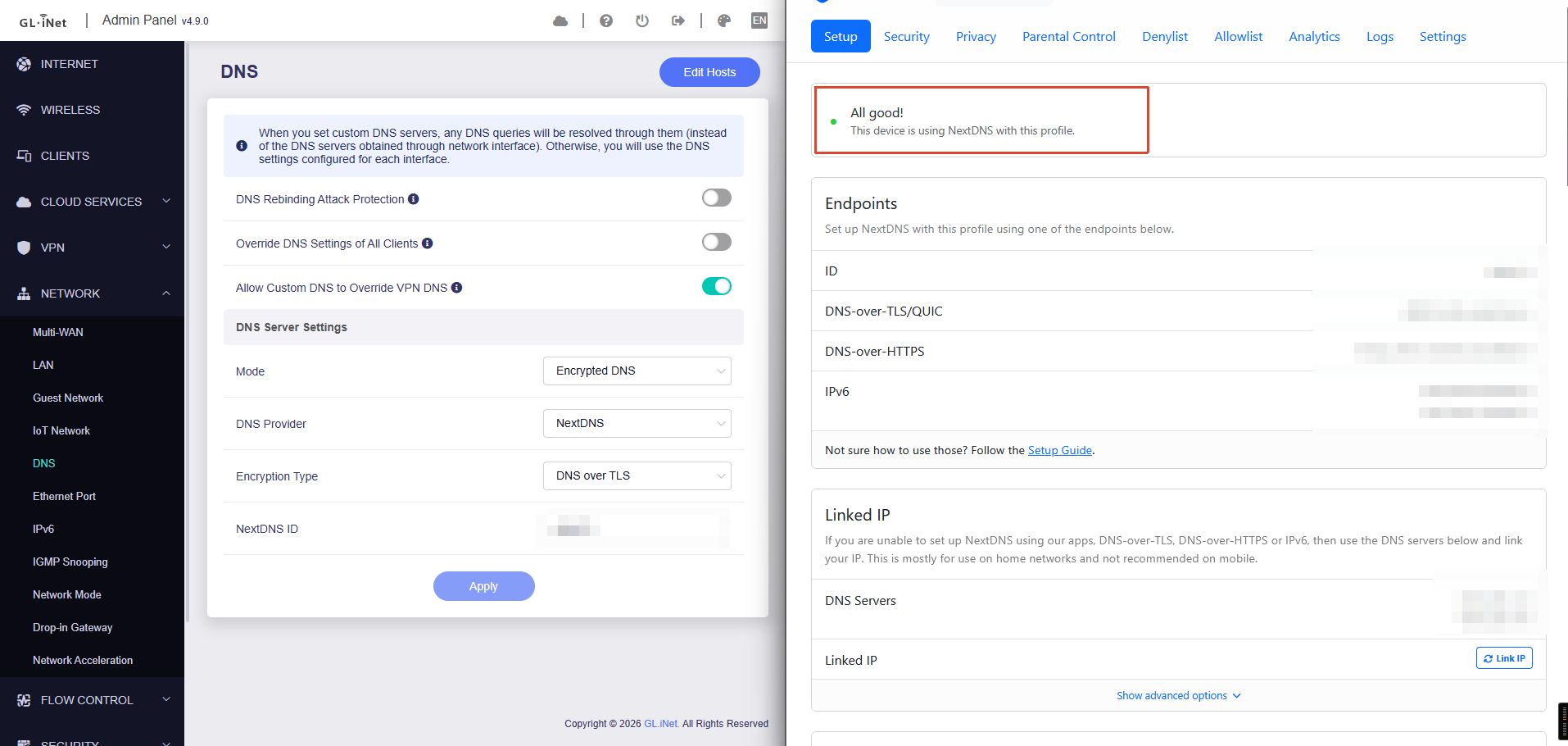

I updated to Release 5 today and started having issues with encrypted DNS over TLS. I was using NextDNS, but no matter which provider I select, it seems to be using Cloudflare, and it wasn’t working in my setup.
The only way I could get DNS working again was to switch back to manual DNS and enter the server addresses manually.
Is anyone else seeing this behavior after upgrading to Release 5?

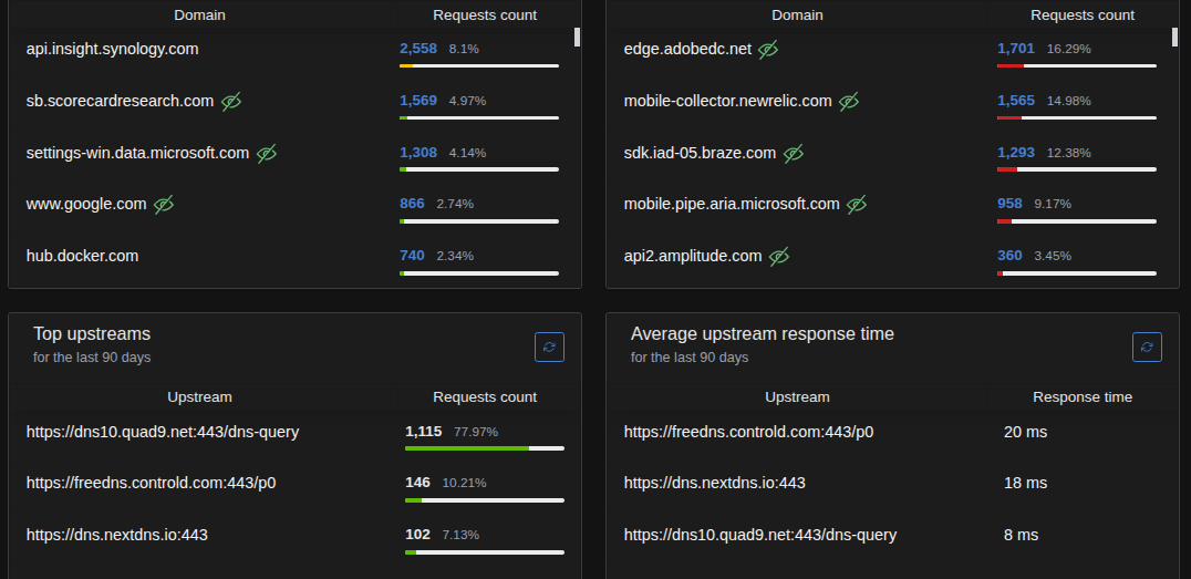

I’m using AdGuard Home, but only as a way to point everything to NextDNS, by using NextDNS as the upstream server, I’m not actually using it for filtering.
Everything works perfectly on Beta 4, so I’m hesitant to upgrade. Are you using AdGuard as well?

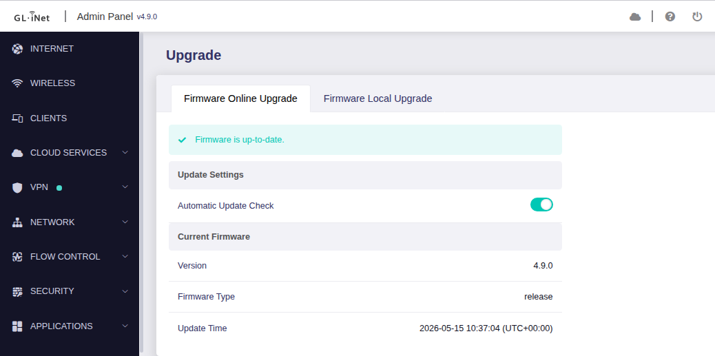

Sorry but where do you see beta 5 written on the screen?
When you download the firmware, it’s titled with the release.
be9300-4.9.0_release5-1022-0515-1778843436.bin

I noticed that Release 5 was moved out of Beta, though it appeared to use the same BIN file. After updating my Flint 3, I was still experiencing the NextDNS issue, but I was able to resolve it by changing the NextDNS ID, saving the setting, then switching it back to the desired ID and saving again. Everything is working properly now.
Thank you for the update.
Yes, it seems that the DNS settings from v4.9.0 beta1 could not be properly retained after upgrading to v4.9.0 release 5, even though the WebUI still displayed them correctly.
And reconfiguring the DNS settings should resolve the issue.
In any case, we’re glad to hear that everything is now working properly.
