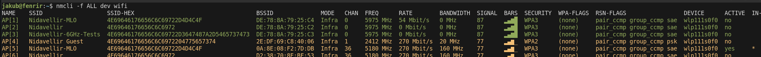

When I check with "nmcli" the 6Ghz bands are visible but bandwidth shows as 0. In the beginning I thought it could be a regulatory issue (I am from NL), but it’s allowed, so I doubled checked the region set on my laptop and router and made sure it’s NL (with iw command). For additional troubleshooting, I reinstalled the linux-firmware package, NetworkManager, and a couple of other components.

screenshot to further show what I mean

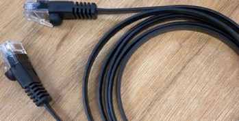

It may not be what you want to hear but 'lay flat' Cat. 6a cable is pretty cheap, with a max. distance of 100 m/328 ft @ 10 Gbps. Cat 6's max. is 55 m/164 ft/10 Gbps. You'll never have to worry about battling crowded Wi-Fi airspace again.

Flat cables do not have the proper twist to most effectively manage rf interference. They are useful, but not ideal. You are welcome.

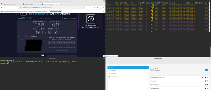

Before, I focused purely on the fault being in the linux firmware package or the NetworkManager I tried all possible things that I could find online in hope it could help. Just now I tried the simplest test possible, a.k.a. live boot from a USB, I don't know why I didn't think of this before. I tested Fedora 42 and Linux Mint 22.1.
With some confidence, I can say that I believe that the Linux kernels above 6.8.0-51 have issues with MLO and 6Ghz bands. Fedora 42 with the kernel 6.14 could not connect to a 6Ghz band and properly utilise MLO same as Ubuntu 25.04, but Mint 22.1 with kernel 6.8.0-51 could.
Below I attached some screenshots from Mint, not from Fedora, since I did not think of it until testing on Mint :sweat_smile:. Funny thing is, bandwidth still appears as 0.
I want to mention though that I am unsure whether this is a direct fault of the new kernel or is it Canonical doing something funky with Ubuntu. But taking into consideration that Fedora 42 with the exact same kernel also does not work, I would hazard a guess that it's a fault of the new kernel.

I would guess you will not have issues with quality flat cables honestly in a home environment.
I can never get flat cables to lie flat.
I've found it best to put some weight on them to first gently stretch out them &/or use tape at key intervals while they 'uncoil' themselves via gravity. It's more bothersome compared to Wi-Fi, sure, but it works for long term placement... & reliability.
