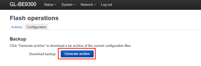

How can I also take a full back up of my current set up before installing it?

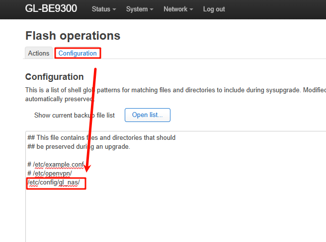

The backup file can be generated via:
Luci → System → Backup / Flash Firmware.
If there are other custom scripts/files that need to be backed up, you can add them to the Configuration.
Creating a backup file and writing down the current firmware version should suffice.
If you encounter any issues with the beta firmware, you can always revert to the current version and import the backup file, avoiding reconfiguring everything.
